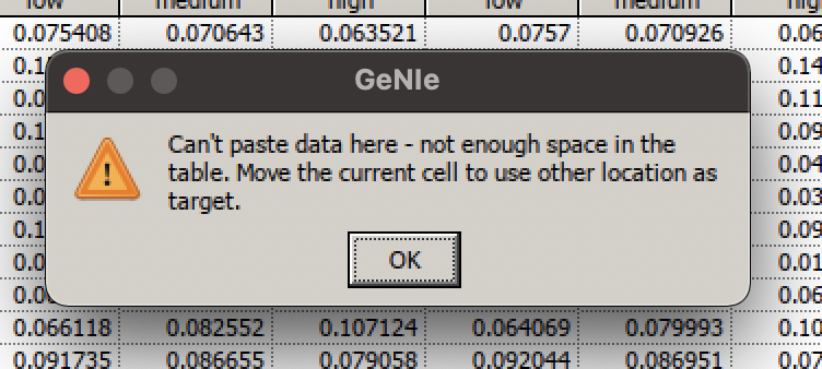

Thank you for replying. and sorry for my late reply.
1. No, I still can't paste from TextEdit the whole table but it does allow pasting a column though. I have attached the error message that show up when i try to paste the whole table.
2. Yes, I can copy and paste from Genie to an Excel file with no problems
Nevertheless, with your idea of trying another program than Excel, I have tried Pages and it has worked well. I can paste the whole table now. so thank you for your help :)
Though it would be more convenient to just paste directly from Excel, my advisor is able to do that on her laptop using the same files (Genie and Excel files), i don't know why i can't.
- Screen Shot 2023-07-22 at 6.27.13 PM.png (212.49 KiB) Viewed 238123 times

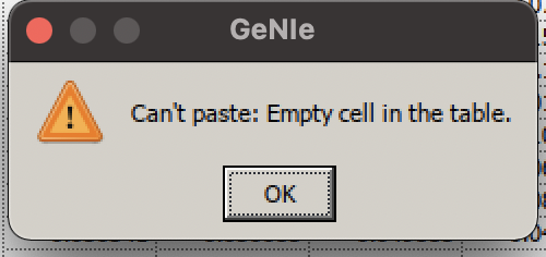

Oh great. cause I am stuck and I have to submit my thesis on Monday, so I would really appreciate the private build. I am using the academic version.
and by the way, now i can’t even paste anything, not even one value, and neither pasting from Pages works anymore.
i have attached the error it is showing
thanks for the help
thanks for the help
- Screen Shot 2023-08-25 at 11.08.38 PM.png (61.1 KiB) Viewed 237721 times
Re: Can't paste data into node cpt
Just sent you a PM with links to GeNIe Academic 4.0.3225. Let me know if copy/paste works for you. What we've found when trying to reproduce the problem was thatr text placed in the clipboard by Excel, then copied to GeNIe running on Wine contain lines ending in the CR/CR/LF sequence instead of just CR/LF.
