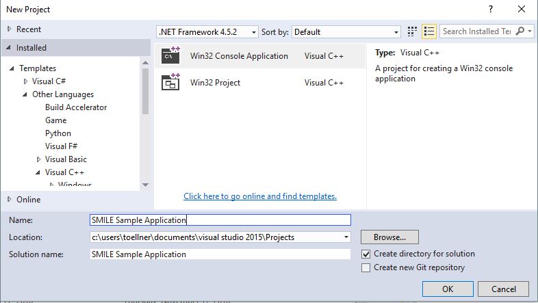

Create a new project in Visual Studio.
Visual Studio New Project.JPG (53.56 KiB) Viewed 282527 times

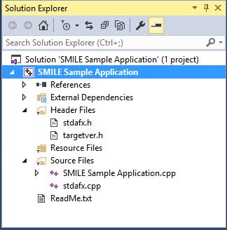

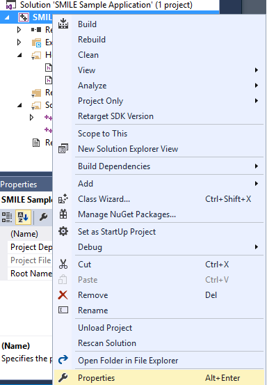

In the Solution Explorer window right-click on SMILE Sample Application (or whatever you named your application).
Visual Studio Solution Explorer.JPG (29.79 KiB) Viewed 282522 times
Select Properties.
Visual Studio Solution Explorer Properties.png (18.98 KiB) Viewed 282522 times

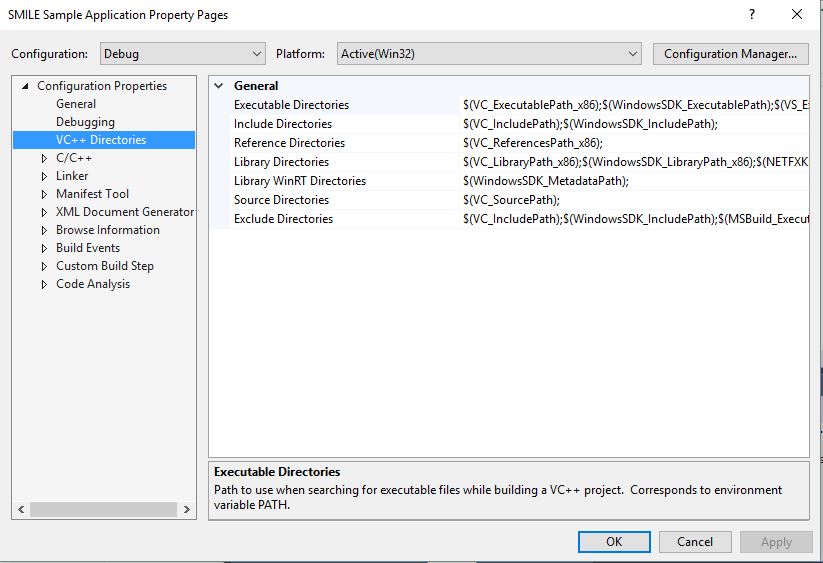

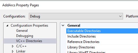

On the properties page select VC++ Directories.
Visual Studio Properties VC Directories.JPG (75.08 KiB) Viewed 282522 times

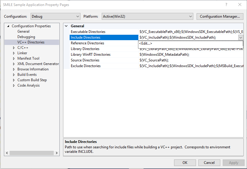

Click on the field next to Include Directories and select <Edit...>.
Visual Studio Include Directories.png (26.05 KiB) Viewed 282522 times

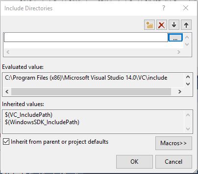

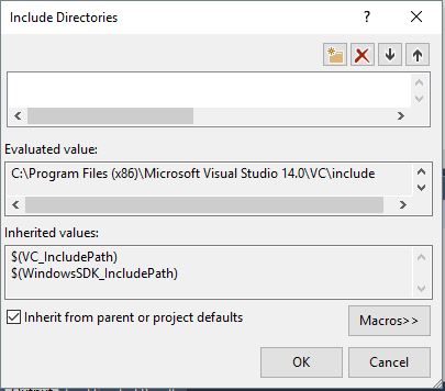

Click on the Folder icon in this window.
Visual Studio Include Directories Folder Selector.JPG (31.91 KiB) Viewed 282522 times
Then click on the ellipses (...).
Visual Studio Include Directories Folder Selector 2.JPG (31.2 KiB) Viewed 282522 times

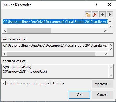

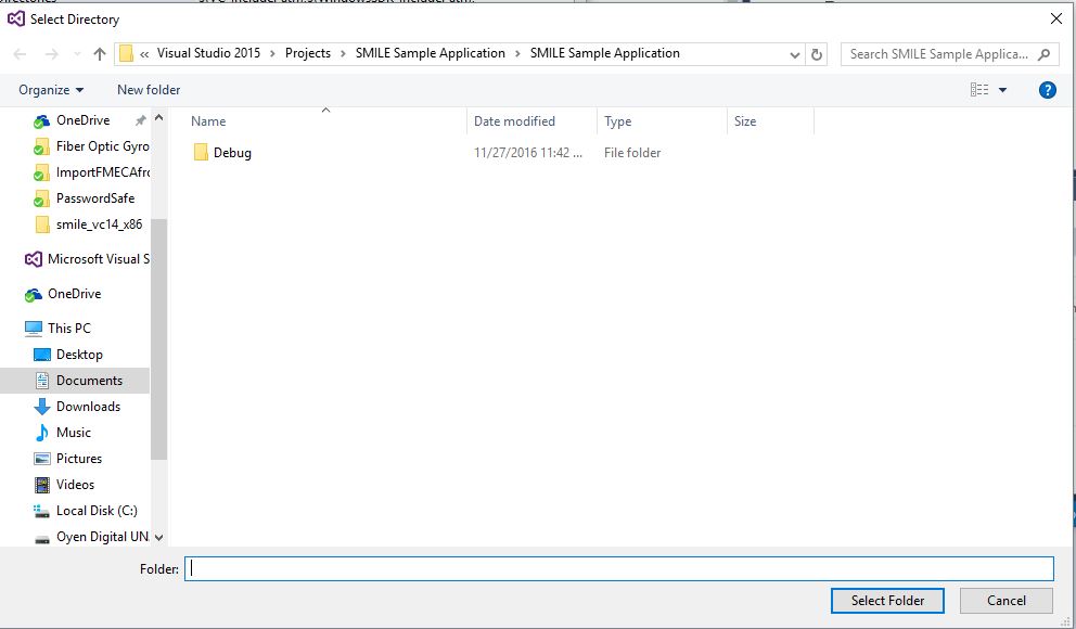

From here you'll navigate to the SMILE folder you unzipped.
Visual Studio Include Directories Folder Selector 3.JPG (57.95 KiB) Viewed 282522 times

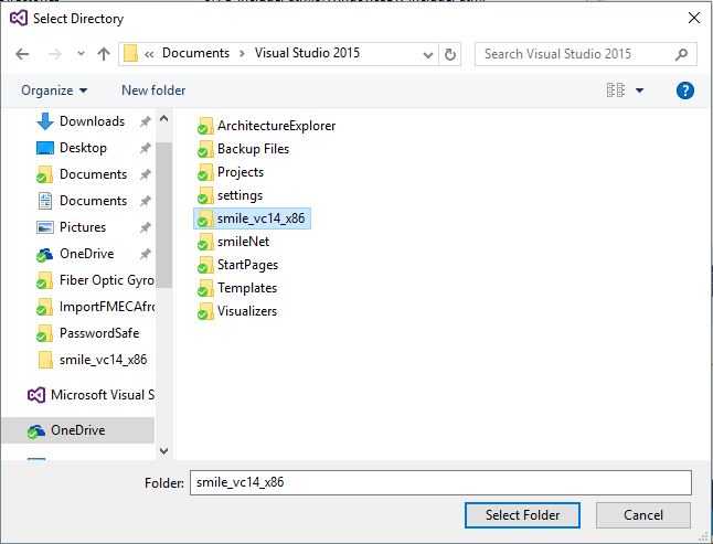

Select the SMILE folder you created from the ZIP file.
Visual Studio Select SMILE Folder.JPG (48.58 KiB) Viewed 282522 times
Click OK here.
Visual Studio Include Directories Folder Selector 4.JPG (34.59 KiB) Viewed 282522 times

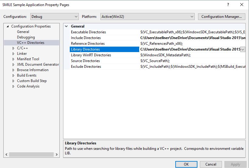

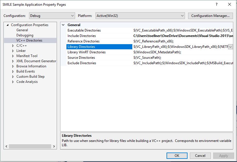

You'll need to do the same for Library Directories.
Visual Studio Properties VC Directories Library.JPG (78.35 KiB) Viewed 282522 times
Follow the same instructions you did for the Include folder.
When you're done with that click OK here.

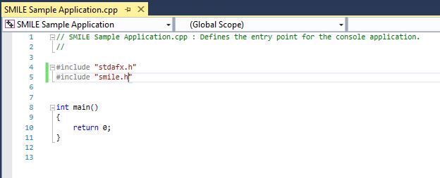

You can now #include smile.h in your code.
Visual Studio Include SMILE.JPG (26.04 KiB) Viewed 282522 times

I figured out the problem. There's a Configuration option on the Property page. I had inadvertently selected Release and should have selected Degub.
