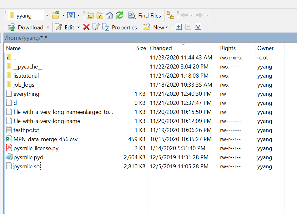

Then I copy the pysmile_license.py, pysmile.pyd, pysmile.so file in the WinSCP as below figure1.

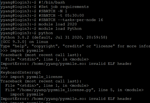

after that, I load python in lunix system. then I pip install some related packages include "pip install pysmile". then in python, I import pysmile and pysmile_license, it showed "ImportError: /home/yyang/pysmile.so: invalid ELF header". In figure 2.
Could you please tell me how can I deal with this problem? I need to created DBN in the lunix system.

It is probably a mismatch between the PySMILE and Python version installed.
Remove pysmile.so and pysmile.pyd from directory you are trying to run program, then uninstall locally cached PySMILE package by typing:
in your terminal.
Next, download recent version of PySMILE with command:
Python should show a successful download message - something like this:
If you do not get any errors at this stage you should be able to use PySMILE. Try it by typing e.g.
in Python console. Note that License file should be present in the folder.
I hope it helps.

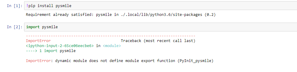

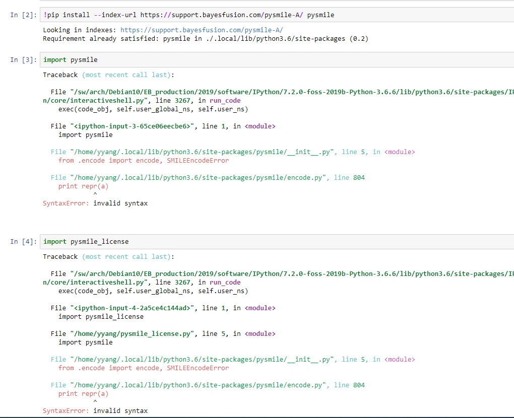

I uninstall pysmile first succesfully, then i remove the pysmile.so file out from WinSCP, then I download the pysmile by the code you sent to me"pip install --index-url https://support.bayesfusion.com/pysmile-A/ pysmile". it shown I download the pysmile package successfully as below figure 1. however, when i "import pysmile"and "import pysmile_license" in jupyter hub by access the lunix system, it shows error as below figure 1.

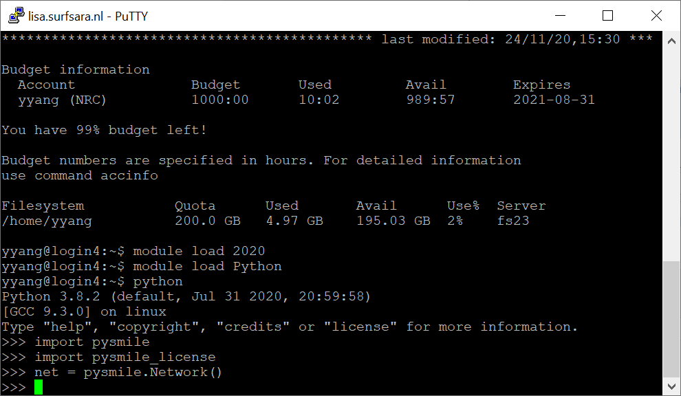

when i access the code package by putty access to the lunix system, i can import pysmile and import pysmile_license as figure 2. but i plan to access the lunix system by jupyter hub website. Could you please what should i do next?

Pip installs PySMILE from local cache. You have to uninstall PySMILE again (pip uninstall pysmile) and install with command: "pip install --no-cache-dir --index-url https://support.bayesfusion.com/pysmile-A/ pysmile"
