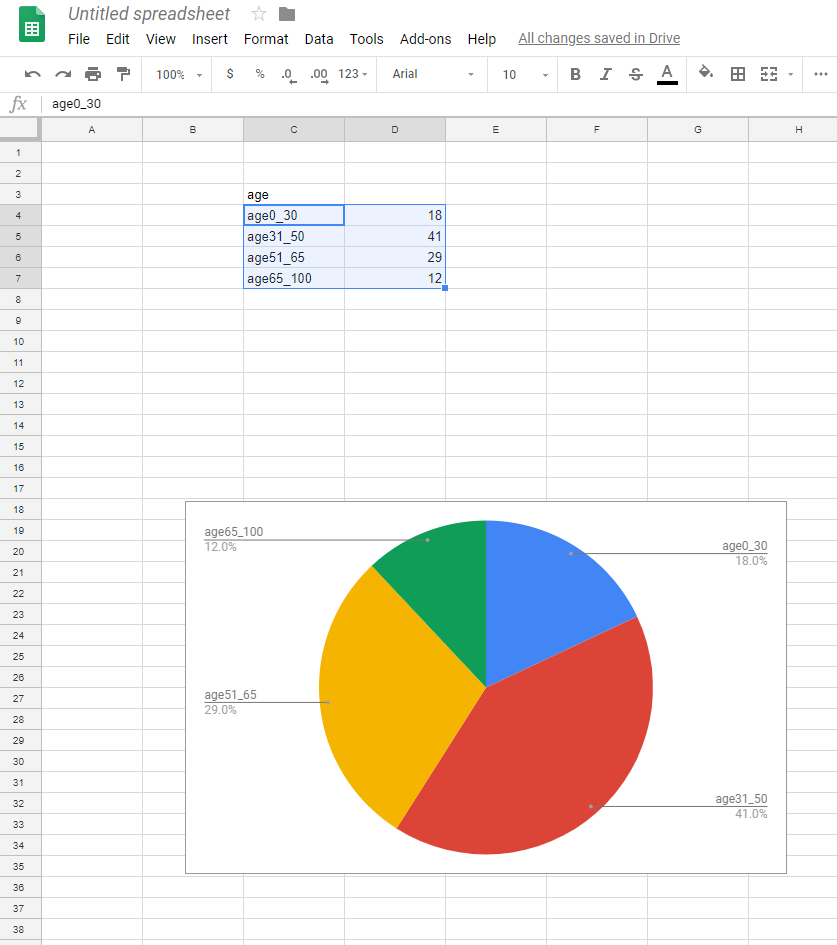

Note that when you use a Copy command in the chart window, GeNIe copies the bitmap but also tab separated name/count pairs as text. You can subsequently paste such text into a program like Excel or Google Sheets and use its graphing features to obtain a piechart with percentages. See the attached screenshot - the cells highlighted in blue were pasted from GeNIe's piechart window.
- piechart-sheets.png (47.19 KiB) Viewed 14461 times
