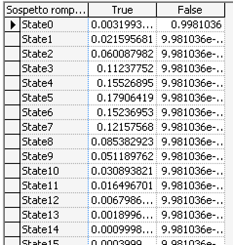

I need zero avoidance in the discretization of some equation nodes with intrinsic (and logically important) zeroes. The option in network preferences works when I push the button "rediscretize":
Screenshot 2025-05-04 alle 11.39.15.png (31.25 KiB) Viewed 427771 times

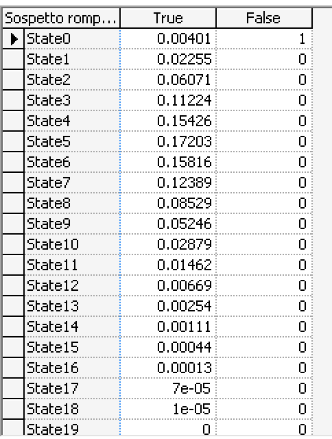

but as soon as close the node properties windows and I open it again (or as soon as I update the network), the discretizaton is performed again WITHOUT zero avoidance:
Screenshot 2025-05-04 alle 11.42.22.png (32.83 KiB) Viewed 427771 times
Is there a way to set zero avoidance once and for all in a network? thanks

Your second screenshot shows the CPT with zero avoidance - there are no zeroes.

Sorry, I wrote the other way around what I really meant. I originally meant "I need a node that DOES NOT avoid zeroes (first original image), but even though I deselect zeroavoidance, any time it is rediscretized for updating it avoids zeroes (second original image)". Then I solved the problem (setting the correct choice for zero avoidance, saving, then CLOSING the file, then reopening it, solves the problem), but I managed to recreate it for you, just in case there is an insidious bug to fix.

Re: zero avoidance in discretization apparently does not work properly
We were not able to reproduce your scenario exactly, but I think we know the root cause of the issue.
GeNIe (or, more precisely, SMILE) caches the discretized CPTs for equations. These cached CPTs are not invalidated when zero avoidance flag changes. Therefore, if you update beliefs and discretization was performed, then toggle the 'zero avoidance' option and update beliefs again, the CPT remains the same.
Please note that CPT created in the 'Discretization' node property page is a preview calculated on the copy of the network.
The fix is of course to invalidate discretized CPTs when zero avoidance changes. The next public GeNIe release will contain the fix; if you need a private build with this modification, let us know.
