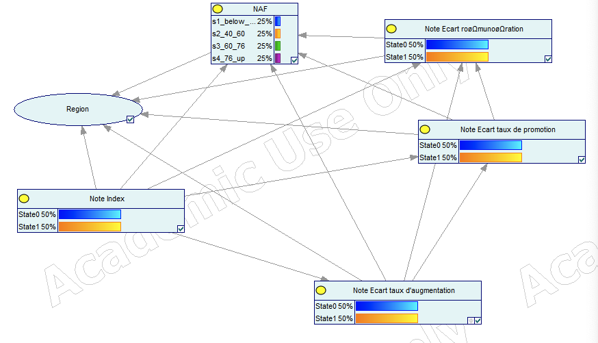

I am ussing data to discover pattern of a subject.
The data is related to salary differences between male and females.
I use the Learn parametres function, and the result seems to show that Region is the final output, when I was expecting the Note Index to be it (this is the fianl note givent by compilation of intermediary notes)
Furthermore the bar chart is displaying equal statistics...
I obviously did something wrong...
Thanks in advance for your help
The 'Learn parameters' command only learns parameters, and works on the model structure already present. Are you referring to the output from the PC structure learning algorithm?

model has been made by the software, and the links proposed are very odd.
My intend is to use the capabilites of the program to propose corralations
