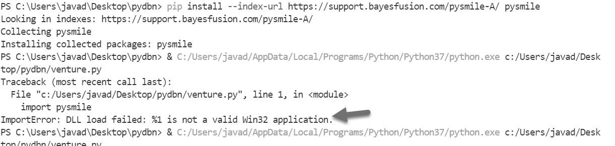

i get this error whrn i run model in python . python version is 3.7
import pysmile
import pysmile_license
ImportError: DLL load failed: %1 is not a valid Win32 application
i have installed package many times and even i have pysmile.pyd in my directiory and i tested with and without it but still i get error . can you help me .

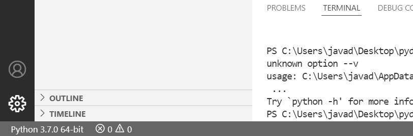

but my python is 64 bit
