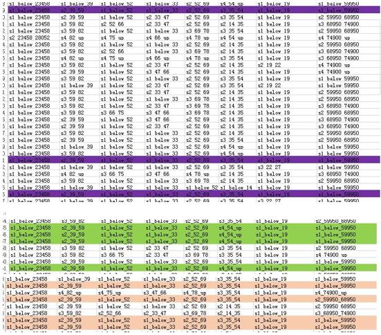

when I discrete the continuous data, many lines of dataset with the same records appear like the attached figure.
at this time, the line of dataset with the same records should not be deleted, is that right? otherwise, that will influnence the results of the stucture or parameter learning. and will make the learning result less accurate.

The answer to your second question is no, you should not delete duplicate records. They are an important source of information for learning frequencies in your data.
