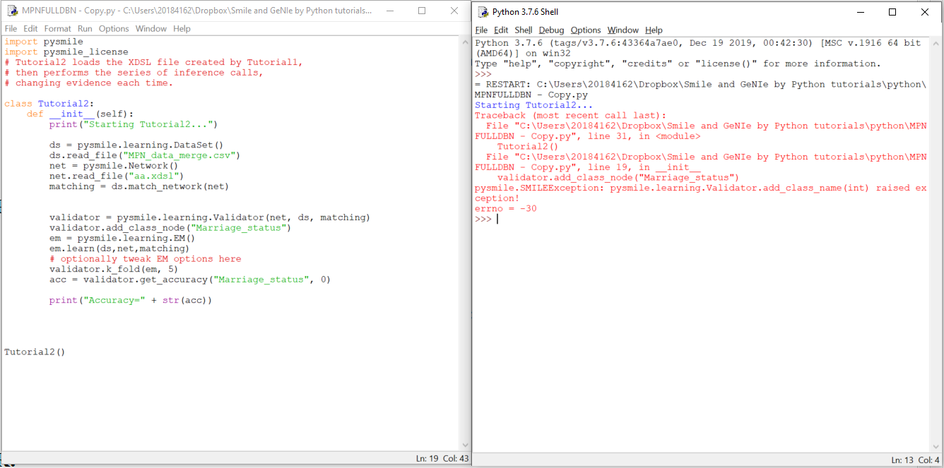

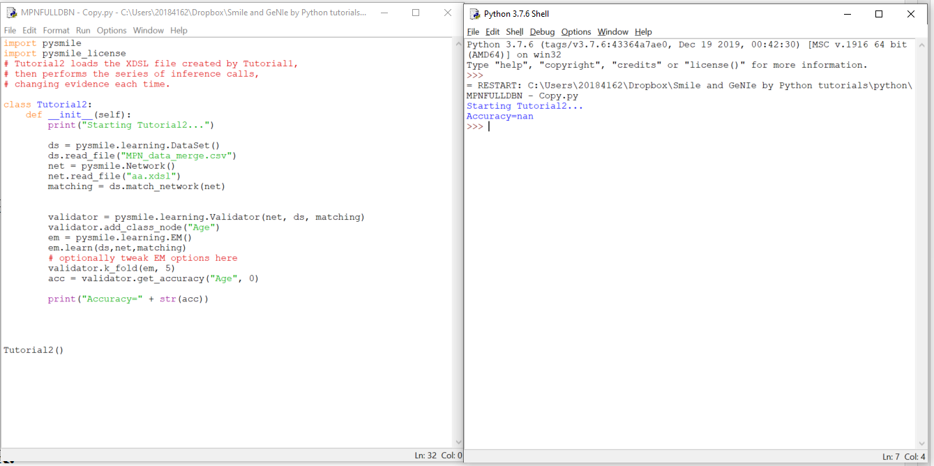

i modify my code, but i get the results "Accuracy=nan". What is the "nan" mean? (the ...2659.png shows the results)what kind of results represent the network is good after the validation? My file.xdsl is a DBN network.
besides that, i use my another nodes like "Marriage_status", I get the errno=-30 (the ...3447.png shows the results). Could you please tell me why? Did i do something wrong?

SMILE does not support validation (including k-fold) in DBNs. You need to unroll your network and run k-fold on the non-DBN model.

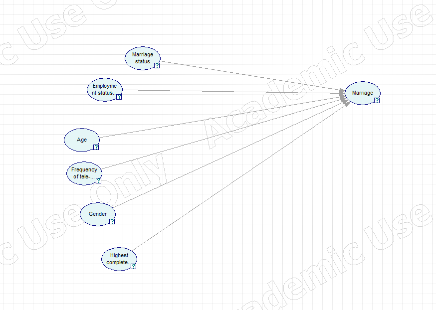

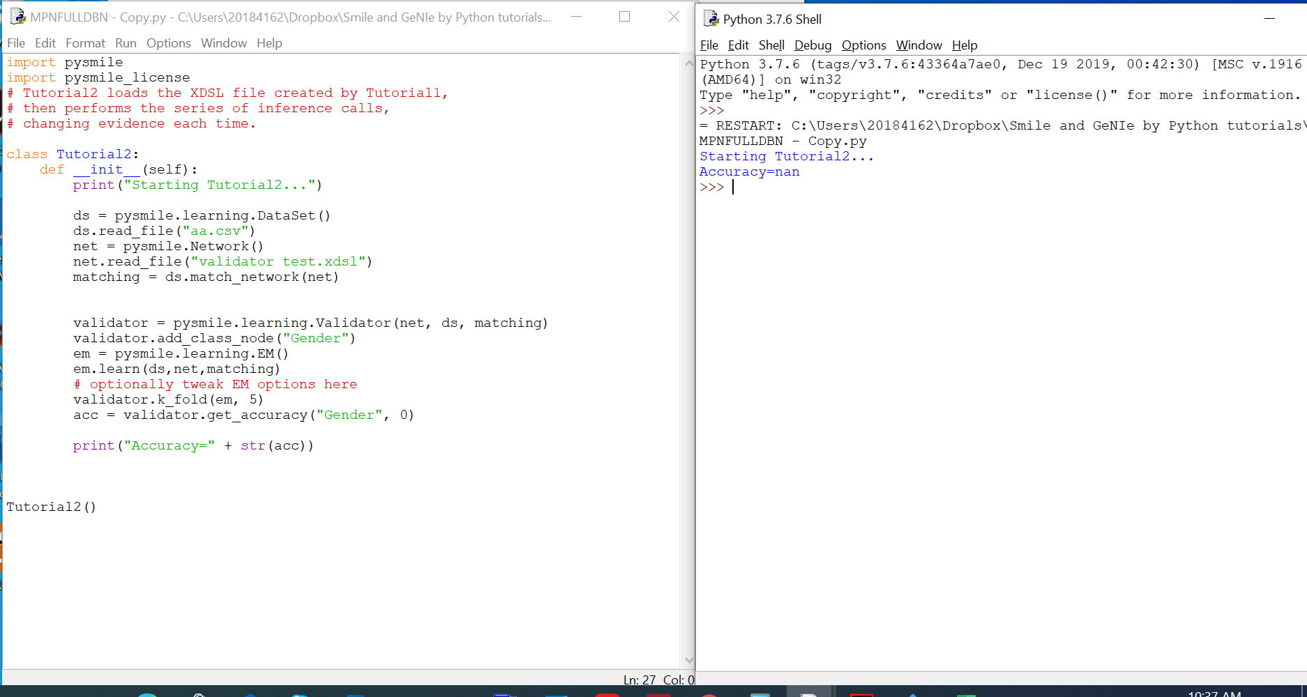

i make a simple BBN network, the network type as shown in picture 4314.png. and use the corresponding data, as shown in aa.csv. but the resutls is "nan". could you please tell me why? and what kind of results represent the network is good after validation?
- WeChat Image_20200722104314.png (34.23 KiB) Viewed 64885 times
- validatorWeChat Image_20200722103759.png (110.8 KiB) Viewed 64885 times

Can you share your "validator test.xdsl" file so we can reproduce the problem?
