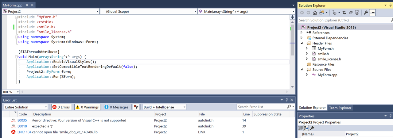

I am having a similar problem and am a novice in VS2017 and CPP. I followed this suggestion, but still received errors. See attached screen shot. Suggestions?

PS: your screenshot shows the Visual C++ code for .NET. If you want to target .NET, your options also include SMILE.NET, which can be used from C# or VB.NET.
