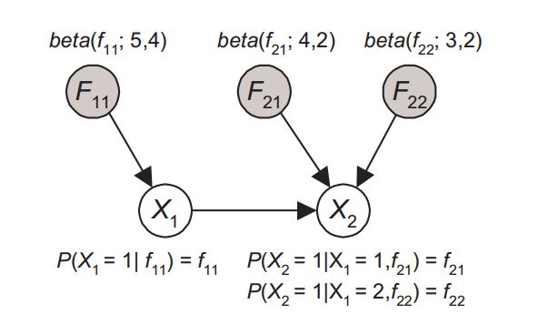

and wish the express the experiment in the following bayesian network (photo attached), and GeNIe filed attached.
I start with assumption that all beta density functions have equal frequency of Beta ( 1,1)
Based in the results above, I can identify that for the node F11 ( of the state of X1), my node should be defined as beta(a= heads, b= tails) => Beta(1+4=5,1+3=4).
Also, for the node F21(which is the number of times X2 = 1 or X2 = 2 given that X1 = 1) => Beta (4,2)
Also, for the node F22 (which is the number of times X2 = 1 or X2 = 2 given that X1 = 2) => Beta (3,2).
If I just draw the nodes as per the attached figure, I get the Node X2 being defined as Node X2 = F21 + F22 + X1 as it seems to be an automated additive function when links are drawn...and end up with a mean 'probability' or >1 which is not correct I know but I can't figure out how to obtain a probability value for a BBN with Beta Density Functions.
I know that with the 'a' and 'b' values, I can work out the probablity of X1, and X2|X1 by hand but I would like to update the network from observing evidence of each run case and changing the a and b values and getting an updated probaility.

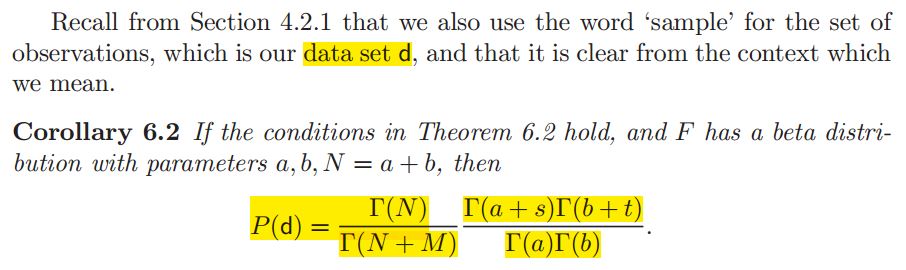

As I understand from Neapolitan's textbook, a beta distribution of a data set can be represented as (or attached as an image, to be able to see the equation with more ease)
P(d) = (Γ(N) / (Γ(N + M)) * (Γ(a + s)Γ(b + t)) / (Γ(a)Γ(b)) , where Γ(x) = (x-1)!
where d is the data set ( of 7 throws of coins), and has a beta distribution with parameters a, b, N = a + b, s, t, M= s+t. P(d) is the relative frequency with which we will obtain data d when we repeatedly sample coins with replacement from the urns and toss each sample pair 7 times.
What I would like is for X1 = p(d) = (Γ(2) / (Γ(2 + 7)) * (Γ(1 +4)Γ(1 + 2)) / (Γ(1)Γ(1)) with the beta density function values of F11 ( Initial a=1, b=1, N=2, s=4, t=2, M=7) ). I notice on GeNIe that there is only the Gamma Log function.

Having re-visit the diagram from Neapolitan's book(I had obtained the diagram from this book), I think that the purpose of X1 is to highlight it as an event with data input from the variable F11. Perhaps there is no way to show in a textbook in an animated way of what data a node consists of ( It's not like when the user can double click on a node and see what data it consists of :-)). I think the author wants to show more distinctly, graphically, that the event, or node, X1 has a probability distribution of F11. Likewise, for the event or node X2, it has the probability distributions of F21 and F22 and is dependent on the event X1.f you tell me what you intend X1 and X2 to express, I will be glad to help
Strictly speaking, the node X1 would take on the distribution of F11, so I would say that F11=beta(5,4) after the 7 runs of coin toss. Initial F11 = beta(1,1)

Thank you for the additional explanation and the reference to Neapolitan's book. I believe I understand your problem better now. What looks like a BN in Neapolitan's book is not really a BN. He wants to show how the parameters of X1 and X2 are calculated based on the Beta distributions (gray nodes). In other words, the darkened circles that look like variables/nodes (F11, F21 and F22) are shown as Beta distributions that influence the parameters and not the nodes X1 and X2. Hence, the figure does not really show a Bayesian network and Bayesian network algorithms will be pretty much useless there.
I have recreated your model in such a way that it gives the meaning to X1 and X2 as the events Heads and Tails (1 and 2 respectively) in a single trial. The marginals show the probability of these events happening. I reproduced the process of generating the samples, assuming your Beta distributions. Please note that the marginals in the model (distribution over 1s and 2s) correspond very nicely to the marginals in your data set -- after all the parameters come from Beta distributions, which were obtained from the data set.
I have also created a discrete model that contains the parameters calculated by Neapolitan. Please note that the two models show the same marginals, which demonstrates that the procedure is correct.
