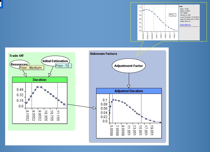

Thanks alot for the quick answer. I see that "body temperature" isn't an example network.
So my question is how to model a continous variable that follows to a certain distribution. I didn't find any remark in the Help.
I could even imagine that I could pull and put a Bézier curve to model the distribution of a variable as within the attachment. Here the node "Adjusted Duration" has two parents, "Duration" and "Adjustment Factor", both continous. "Adjustment Factor" is modeled as a Bézier curve. "Duration" has also two parents, both discrete.
I'm wundering how this is realized within a Bayesian network tool.

Re: Continuous variables - body temperature
You need to add a continuous node and set the required distribution in the "Definition" page of its properties. There are multiple probability distributions available - see the "Functions and operators" pane. At this point there's no "freehand" option with bezier representing the PDF. The closest thing would be the CustomPDF function, which accepts the list of numbers representing the point on the PDF line-segment approximation.So my question is how to model a continous variable that follows to a certain distribution.
"add a continuous node"? May be you mean an equation node? There I can choose probability distributions.
Unfortunately the GeNIe documentation doesn't tell anything about equation nodes and its integration in a BN.
Equation node === continuous node.paaddor wrote:"add a continuous node"? May be you mean an equation node? There I can choose probability distributions.
