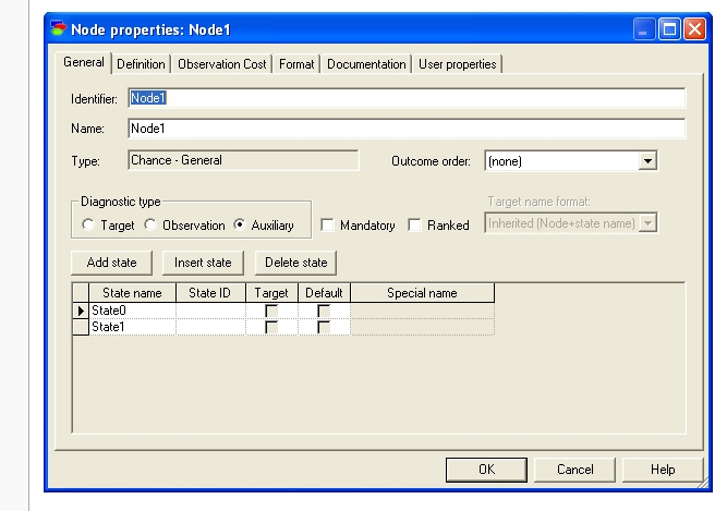

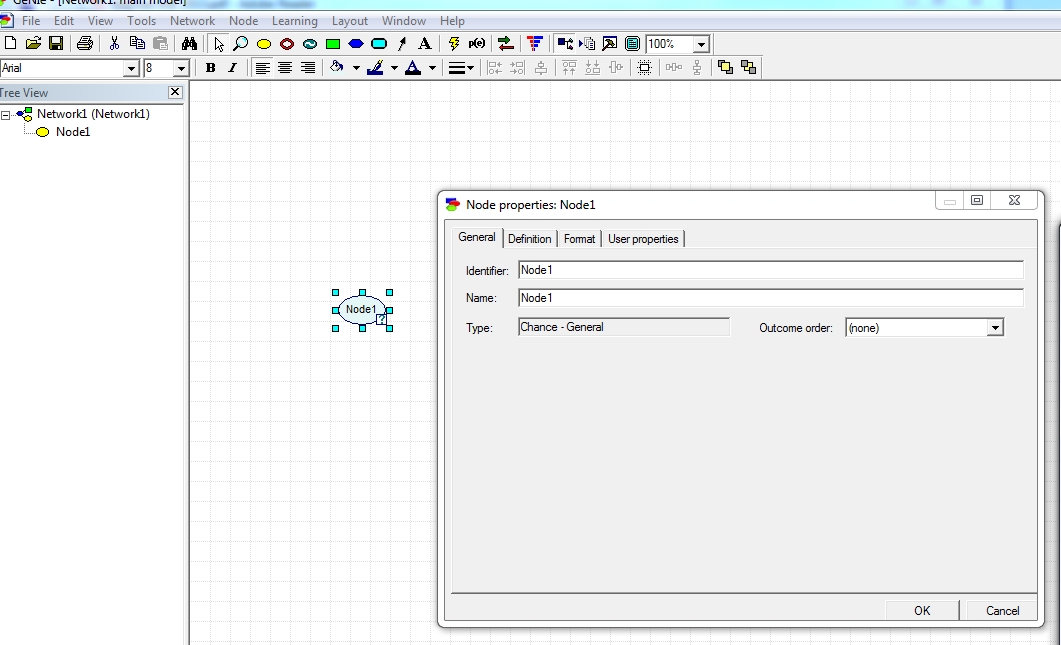

I am a complete beginner in GeNIe, and am working through the online tutorials - in setting up the node properties in my version, I noticed that the dialogue box has limited functionality relative to that shown in the tutorial (please see screengrabs of 1. GeNIe tutorial node properties dialogue box, and 2. my node properties dialogue box). Can anyone tell me why this would be and how I could solve it?
GeNIe Tutorial Node Properties Dialogue Box.JPG (106.86 KiB) Viewed 6395 times
My Node Properties Dialogue Box.JPG (201.8 KiB) Viewed 6395 times

The additional GUI controls will be shown when you select 'Enable Diagnosis' from the 'Network' menu.
