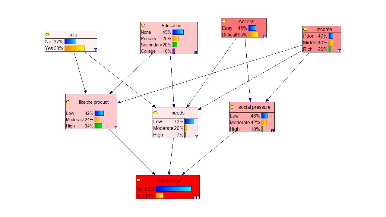

Could you help me to "modify" the result of tornado diagram in sensitivity analysis? I attach the images of sensitivity analysis and tornado here.
(1) I set "use product" as the target node. in the sensitivity analysis, node "access" is redder than others. Then I conclude that "access" is the most sensitive variable to the target node "use product".
scheme with sensitivity analysis

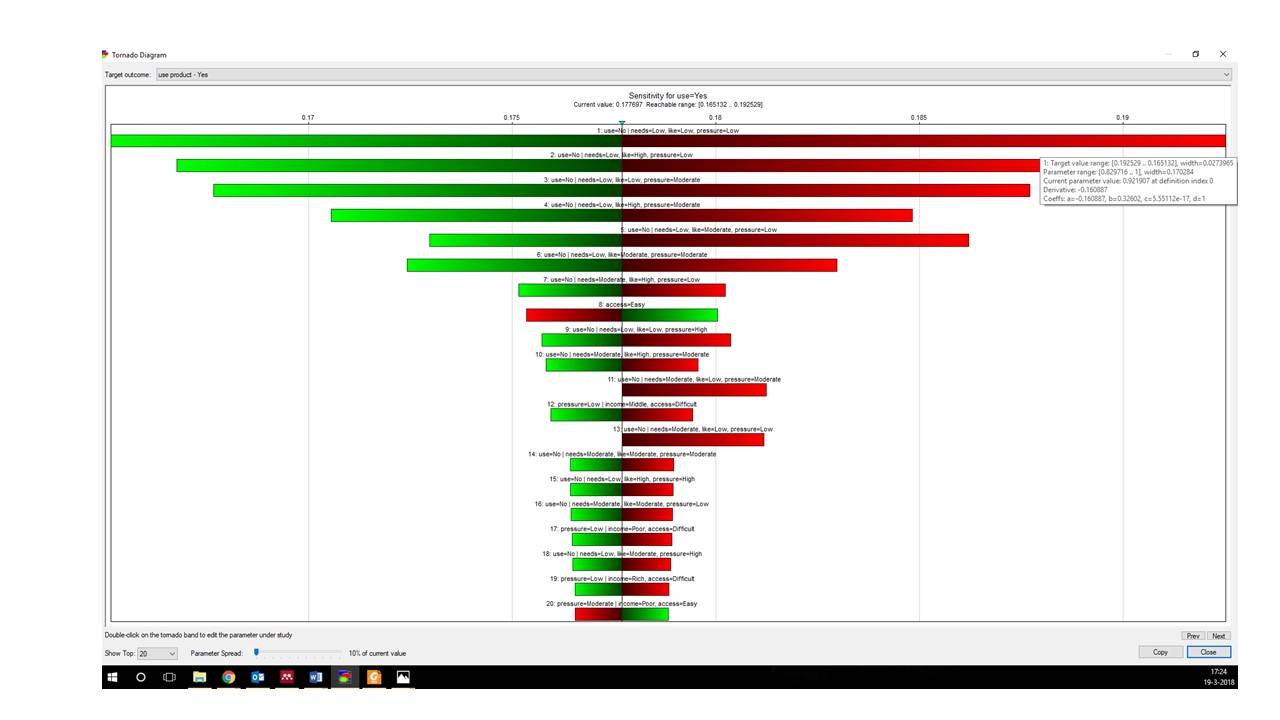

(2) When I run tornado diagram, I see that the most sensitive one is written like this:
use=no|needs=low, like = low, pressure = low, the value ranging from 0.165 - 0.192.
I know the result represents what will happen if I change the CPT value in node "use", state=no, and the box under the "needs=low, like = low, pressure = low".
tornado result
tornado result

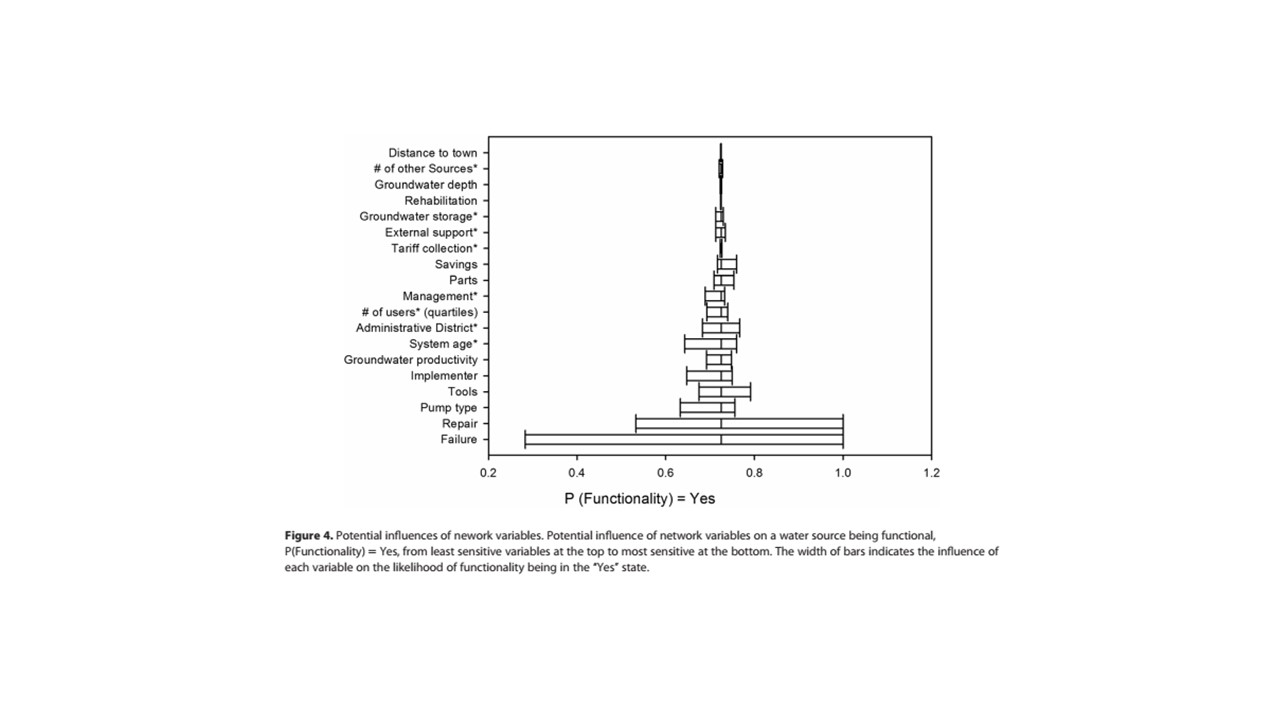

Is there any way to "convert" the result of (1) to be like (2)? Or "quantify" the red colour indicator and make numbers out of the red colour? So let say I will get the diagram with nodes only and not their combination and states like in the tornado diagram (please see "sensitivity analysis diagram example" file in the attachment).
example of sensitivity analysis

Re: about the sensitivity analysis result
You can get maximum node sensitivity by hovering over the small tornado icon displayed in the corner of each node - this will open a small tooltip with max/min/average sensitivity of node's parameters. You'd have to write down the maximum value for each node and use these numbers to create your own tornado display.
These numbers are minimum, maximum and average sensitivity for the node's parameters. Each of the node's CPT elements has its own sensitivity number; to color the nodes in shades of red GeNIe uses the maximum.
