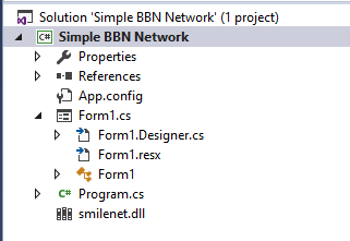

I have a basic Visual Studio (2017) question. If I create a new project how do I add smilenet.dll as a reference.
I can add it to the solution explorer but the "using Smile;" statement doesn't find it.
