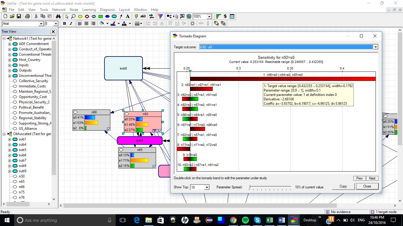

Just to illustrate, I have provided a screen shot of the tornado results on an obfuscated form of my model. The target for this test is 'n92'. Node 'n92' is one of 7 highest level chance nodes in the model. These 7 chance nodes normally connect to utility nodes to produce a combined model output. For the Smile library based code we wrote I had to remove the utility nodes as we have had trouble handling them. The very sensitive node here is n86 = low (parameter location as indicated in the screen shot). The node 'n86' is in the nearby submodel 'Sub7''. I have also included this obfuscated version of the model with the utility nodes removed and the attached spreadsheet contains a relevant portion of the results from the 'brute force' code. Note the two relevant target values are shaded yellow (H2 and H3).

Thanks for sharing your model with us. I can confirm the discrepancy; we're analyzing the issue now.

The problem is caused by non-normalized CPT column in node n86. You have 0.99999999 (1-1e-08) in the first entry, followed by two 5e-08 values. These sum up to 1.00000009. If you remove the last 9 and use 0.9999999 (seven nines) for s0, the sensitivity results will be consistent with n92 posteriors calculated by inference after modifying n86.
GeNIe does check for non-normalized distributions, but we use epsilon larger than 1e-08. Normally this is not an issue, but CPTs like n86 have very large magnitude difference in single columns. We'll need to review this approach given the problems you've experienced.
