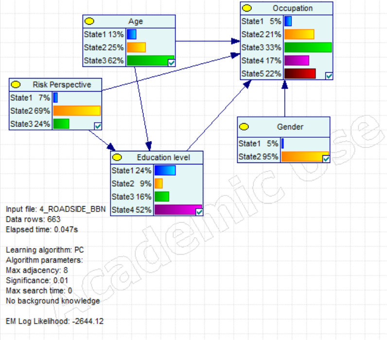

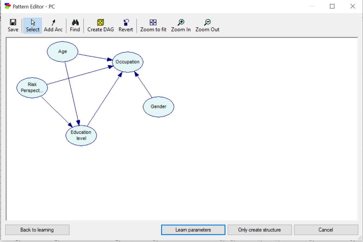

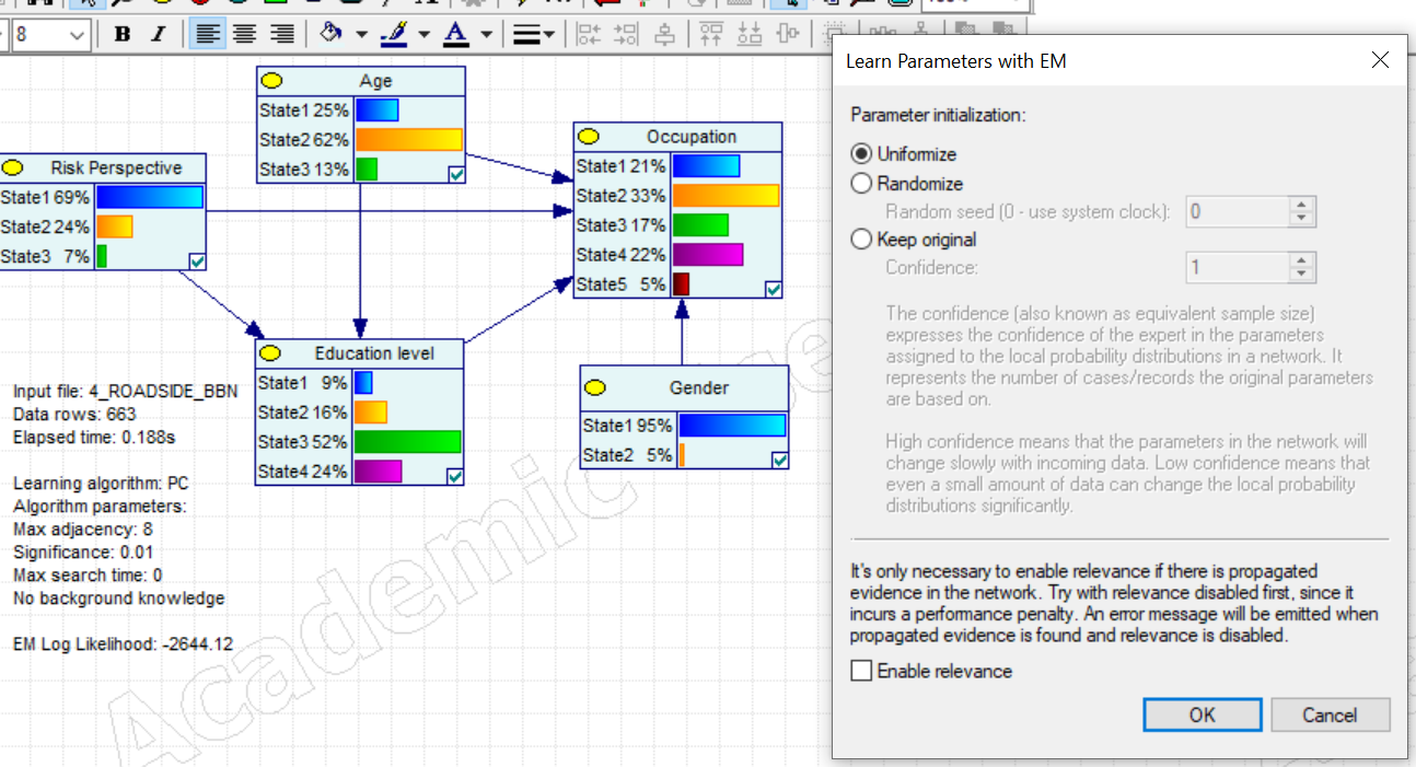

From a complete dataset, i used pc algorithm for structure learning (A DAG was formed). Then parameter learning was done. Then marginal probability was found. But when i further done parameter learning from the same data set, the marginal probability was changed. In example, first gender state 1 was 95% but after further parameter learning it was 5%. What is the reason? Step by step figure is attached below. Thanks in advances.

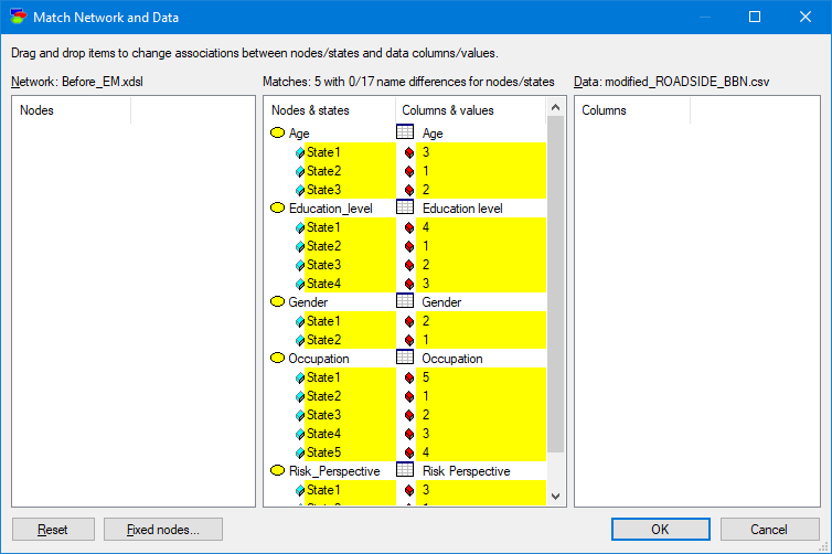

The problem probably is related to the automatic matching between data columns and network nodes. Your data file contains numeric indices. During structure learning these indices are converted into string outcome identifiers. The PC/EM does it internally and there's no issue. Later on, when you run EM again, your numeric data is not automatically matched to proper node outcomes - see the attached image and the yellow elements in the center list.
The easiest workaround would be to convert your data to labels (1 -> s1, 2 -> s2, etc). This approach will avoid the mismatch. Alternatively, you can drag'n'drop items in GeNIe's match network and data window, but this of course is a boring manual process.
