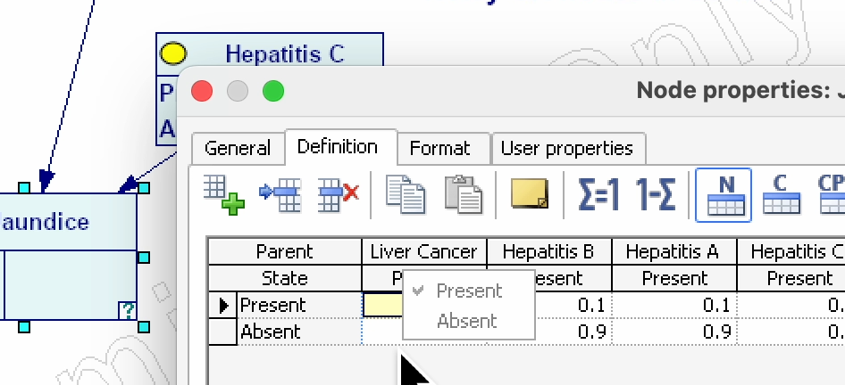

Hi, in GeNIe academic 5.0 (installed on a Mac 32 bit by Crossover) the noisy max nodes, Net parameters window, do not allow switching between parents' states. The menu for switching states appears, but it stays gray and is inactive (see attached picture; the picture is from one of your noisy max examples just to be sure - I first realized the problem on my networks).
Screenshot 2024-12-13 alle 18.21.58.png (132.23 KiB) Viewed 280882 times
Re: possible bug in noisy MAX nodes, version 5.0
Bug confirmed, I will post here once the fix is available.
GeNIe build 5.0.4830 is now online and has a fix for the bug you've found.
