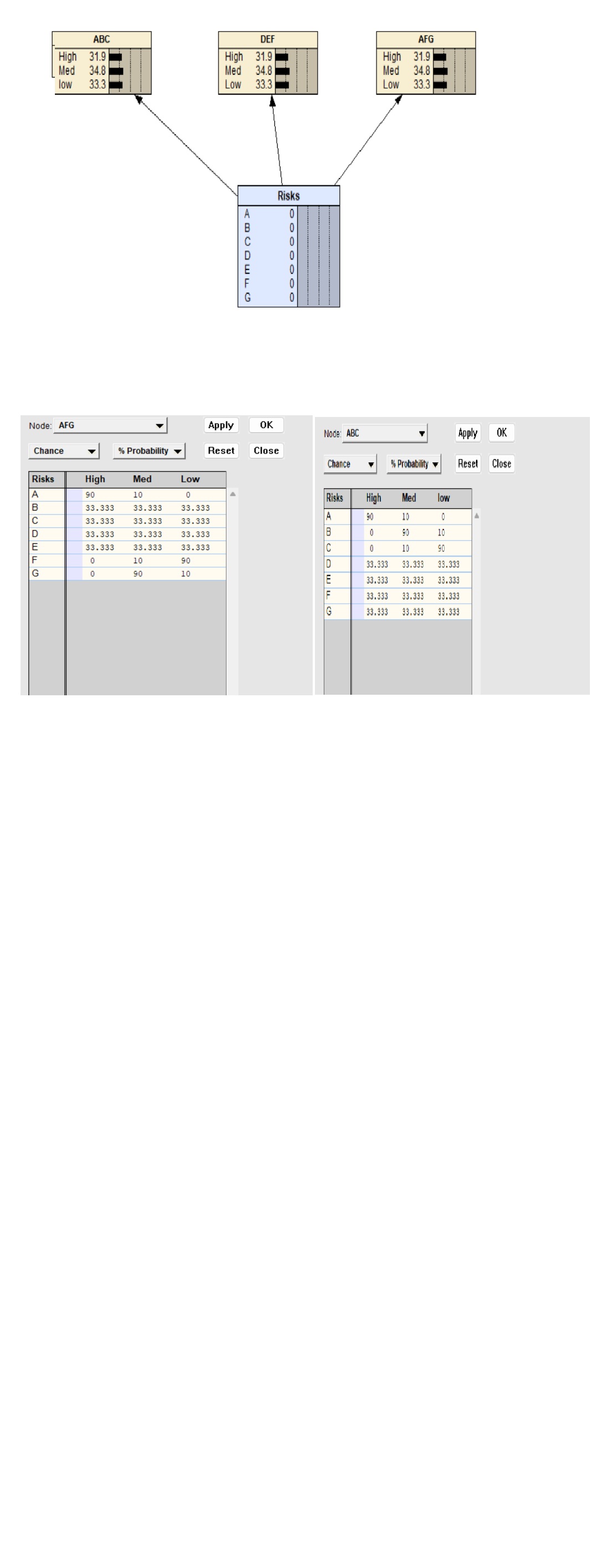

I have attached a simple case for your refrence. the problem i am facing in equal probabilities for the ineffective states of Decision node in the child nodes is that as model propagates the decision node results converges to mostly medium.
I also thought of putting a filter node (noisy or) inbetween the two to limit the unnessary states of the parent node but not successful yet.

The screen shots are not originating from GeNIe and are confusing. My original advice is still standing. You should change the uniform probabilities into the probability distributions that will be there when the node Risks has no effect on the children nodes.
