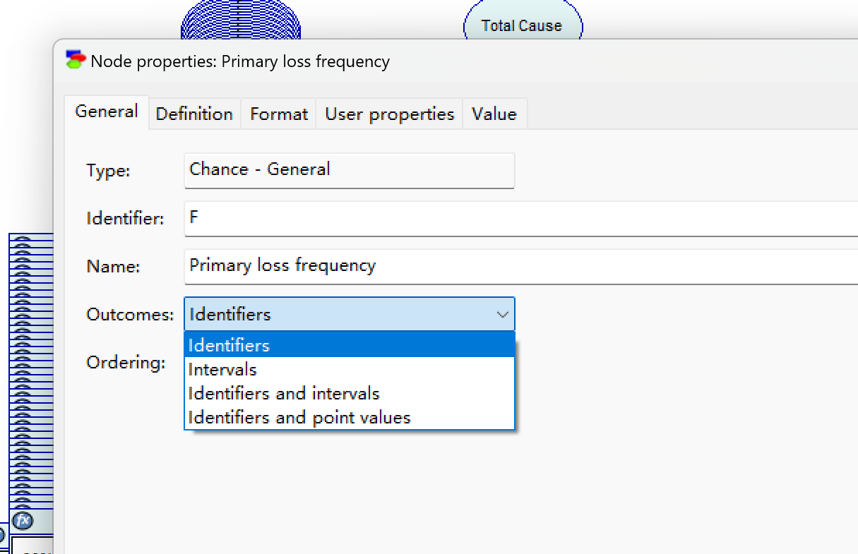

I found that when the state of a node is interval, this indexing method seems to be invalid, such as F=0 means that the first state. How to do it correctly?

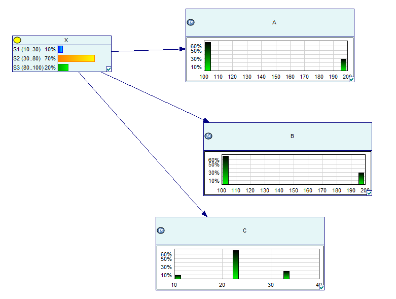

When the parent node is discrete and has intervals, the child equation node sees the value drawn uniformly from the interval selected by the posteriors of the parent (they are known when sampling is run, because discrete parent precedes the equation child in network's partial order).
In your example, you refer to parent F by equating it to zero. This will not work, even if the parent's interval incudes zero.
You have three options, see the attachment for a working example.
1. use intervals with identifiers in the discrete node. In such case, equating the parent with its outcome label will work as you'd expect. The child equation in the example is:
The child node id is X, and it has a states defined with both intervals and identifiers. "S2" is the state id.
2. use the And function in the If function, and specify the interval boundaries
The parent's state has the lower bound equal to 30 and the upper bound equal to 80. This will effectively return 100 if the parent is in the specified state, and 200 otherwise
3. when the intervals are used with identifiers, you can also use the Choose function:
The parent in the example has 3 states. Choose will automatically translate parent value into the integer state index, and will return 11, 22 or 33.
A=If(X="S2",100,200)2. use the And function in the If function, and specify the interval boundaries
B=If(And(X>=30,X<80),100,200)3. when the intervals are used with identifiers, you can also use the Choose function:
C=Choose(X,11,22,33)- Attachments
