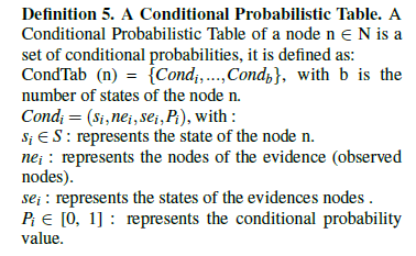

i have this definition
and i want to get the nei
please how can i get it.
Re: node evidence
I am a little confused, as in the Bayesian networks world we call the probability tables that are the definition of a node CPTs, Conditional Probability Tables. They are indexed not by evidence but by the various combinations of the states of parents of the node. It is possible that they mean something else than a CPT in this definition. I cannot establish this based on just the definition.
Generally, for CPTs please look for the methods in SMILE that operate on the definition -- there should be methods that get individual elements of the CPT. If, on the other hand, the definition that you placed in your query refers to conditional (posterior) probabilities after observing the evidence, please look at the methods that get the value of the node.
