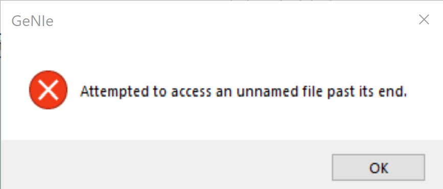

When trying to copy an equation node from one file to another, I get the following error:

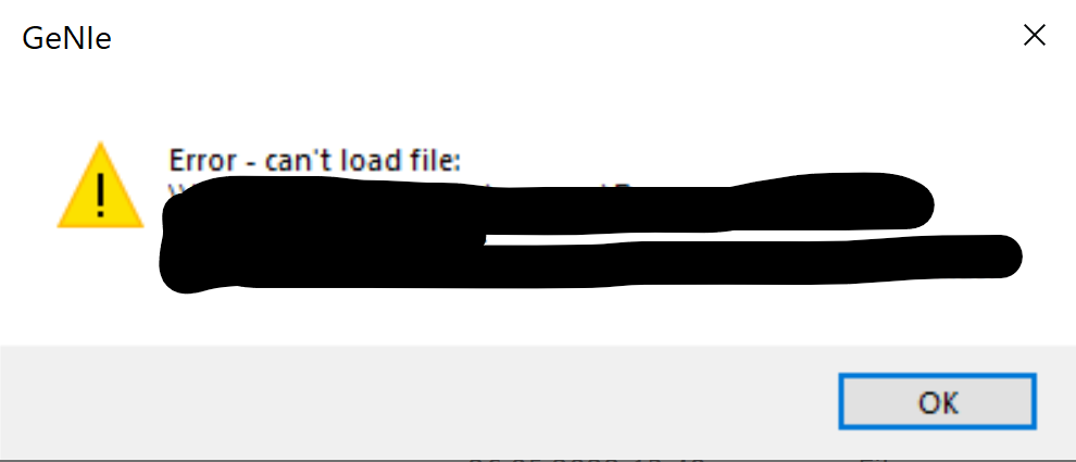

When I then save the file, and try to re-open it the file is corrupted:

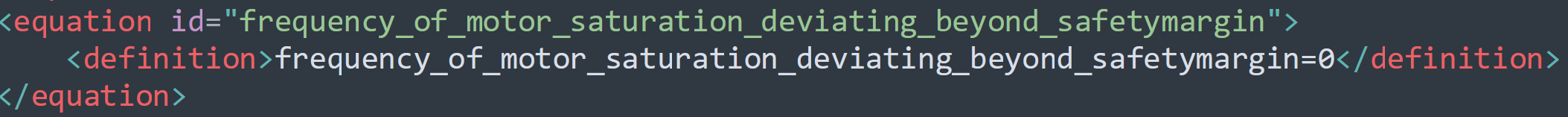

The error is related to this new entry in the file:
There is no entry for the node under <extensions>, where the color and location for all nodes are given.
The error is solved by removing the new entry.
