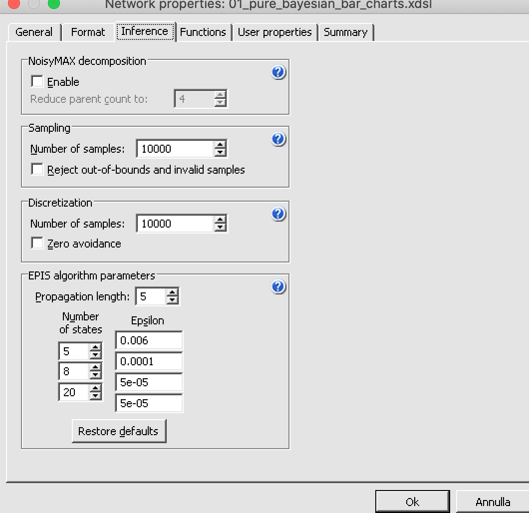

The attached file shows the inference page of the network properties, on my computer. I can't find the rando seed there. can you please specify where it is? thanks
Schermata 2022-08-04 alle 10.57.51.png (85.91 KiB) Viewed 16009 times
Re: set the seed of random number generators in equation nodes
Please update your GeNIe version to 4.0 - it's available at our download site (https://download.bayesfusion.com)
