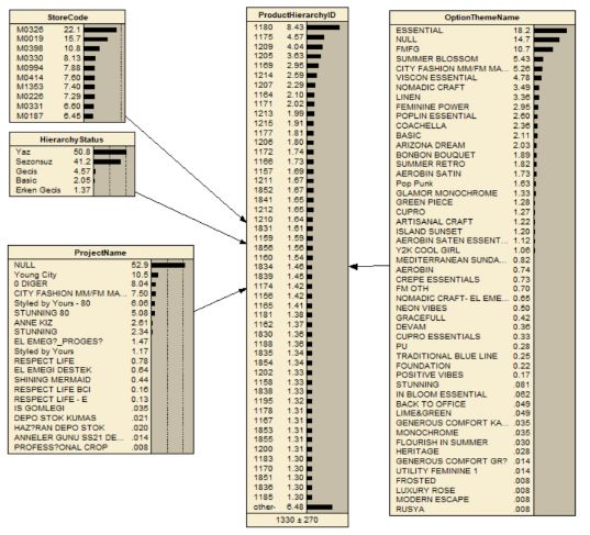

I am adding an example of BN that i created. Store numbers are limited to 10 in this example but it is 400 actually. PHID shows the product sold. Many nature will be added after I figure out how to do
I am not sure how to add time in this BN. One week's data included in this example but i need to add 53 more. I thought a new nature node called week can be added and states of it will be week1, week2 etc. However, number of the data will grow exponantially.
Also in some papers I read, some features like colour or fit is added after sales (PHID in example). But as I consider it is not the result of sales, it is a reason of the sales. So it should be causing the sales as I draw in example.

I roughly see what you want to accomplish. I'm afraid your CPT in node PorductHierarchyID will have 40,000 conditional probability distributions and given that the node itself has 50 states, it will have 2,000,000 probabilities. If you multiply these by 8 bytes needed to represent a floating point number, you are getting a very large table. You also want to model explicitly time. This will add additional complication and requirement to increase the space needed for the CPT. You want the moon :-). Netica (I believe your model so far is represented in Netica) is a well written, efficient software. While SMILE may be faster and mode efficient (we have actually never tested this), it will not be enough to help you. I think you need to start thinking about your problem in a different way. The way you are pursuing will not work with any Bayesian networks software.
