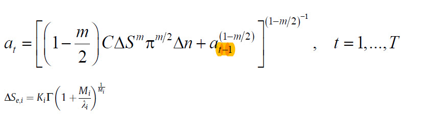

in my case i want to discretize this equation. this equation is time-invariant. a(t) = dt
K and M are lognormal and Kt=K0 and Mt=M0. and others are deterministic; and as you can see in equation dt is depending to previouse time step too (dt_1).
is my model is true for discretize dt and use it's CPD IN DBN for t>1 in ?

The equation that you reproduced is not time-invariant and is a difference equation. Very clearly a_t depends on a_{t-1}. Please reflect on which of the variables/symbols in the equation are constants/parameters and which are actually dynamic variables. Then how they interact. This is the best I can do for you. I will be happy to get hired to do this work for you :-).

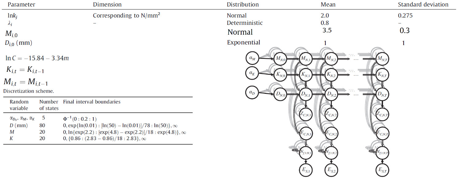

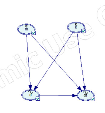

If I understand what you mean, you said you could help me. Yes, I will be very happy if you can help me in this particular case as well. These are the equation data and this is the Bayesian network in question. I would be very grateful if you could check to see if the conditional probability table for node d can be obtained with the previous time step condition or not!
just a tip about node K, i want to use ln(k) instead of k in equation with normal distribution with mean=2 and s.d=0.275
Thank you

Let me just answer your question about node d. The graph structure in your image shows that d_i is dependent on d_{i-1}, although the actual equation for d_i does not seem to be present in your image.
There is no problem with using logarithm in an equation in GeNIe -- you can use any function from among those listed on the right-hand side of the definition tab. At the moment, to use an equation node in a DBN, you have to discretize it first. We will integrate hybrid models with DBNs at some point but probably not in the next few months -- we have other important tasks ahead of us.
