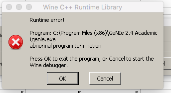

when I use 17 million data to learn the BBN structure, even I only use 10 variables to learn the BBN structure, it shows me "abnormal program termination" as below figure.
when I import external DBN data and use 17 million data to learn the parameter of this DBN, it also shows me "abnormal program termination" as below figure.
I did these two procedures by GeNIe in MacBook Pro, it showed me this figure. Actually, at first, I did these two steps by GeNIe in the HP windows system, it directly breaks down showed me nothing. I thought maybe the memory problem in the windows computer, so I change to MacBook Pro, but the results are the same, break down.

when use 17 millions data to learn the structure and parameter of network, it shows: abnormal program termination

Can you send me a link to your data file using private message on this forum?
Also, please note that GeNIe Academic is 32-bit only and its address space is limited to two gigabytes. I believe part of the problem here is dataset size.

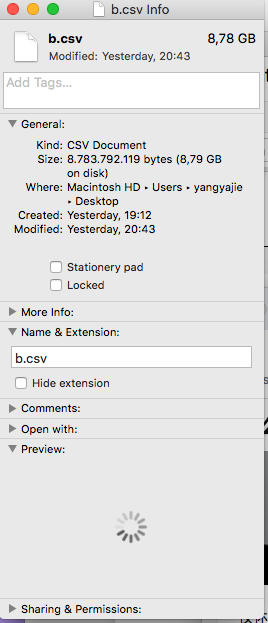

The size of your large file on disk suggests that 32-bit GeNIe Academic will not be able to handle it. SMILE Academic is available as both 32-bit and 64-bit, so there should be no problem with the memory size.
When you run structure learning, make sure that your HHID and PERSID are not used - they identify the person and seem to me to be unique. Your network should not include a node which has one state for each person in the dataset.
