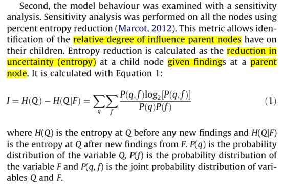

I was wondering if what you describe here is the same as the "percent entropy reduction" used in this paper:
https://www.sciencedirect.com/science/a ... 1X13000887
- Entropy reduction.PNG (96.11 KiB) Viewed 221897 times
Re: Entropy reduction
Hi Lotte,
Somebody else at BayesFusion will answer your R question. Let me just comment on the entropy reduction question. The formula used in GeNIe/SMILE is somewhat different. We calculate cross-entropy, which is the expected difference between the entropy of the target and the entropy of the target given the observation. I recognize the left-hand-side of the equation but not the right hand side. Unless I am missing something obvious, our calculations are somewhat different. Also, GeNIe calculates it for any node, not just a parent of the target variable.
