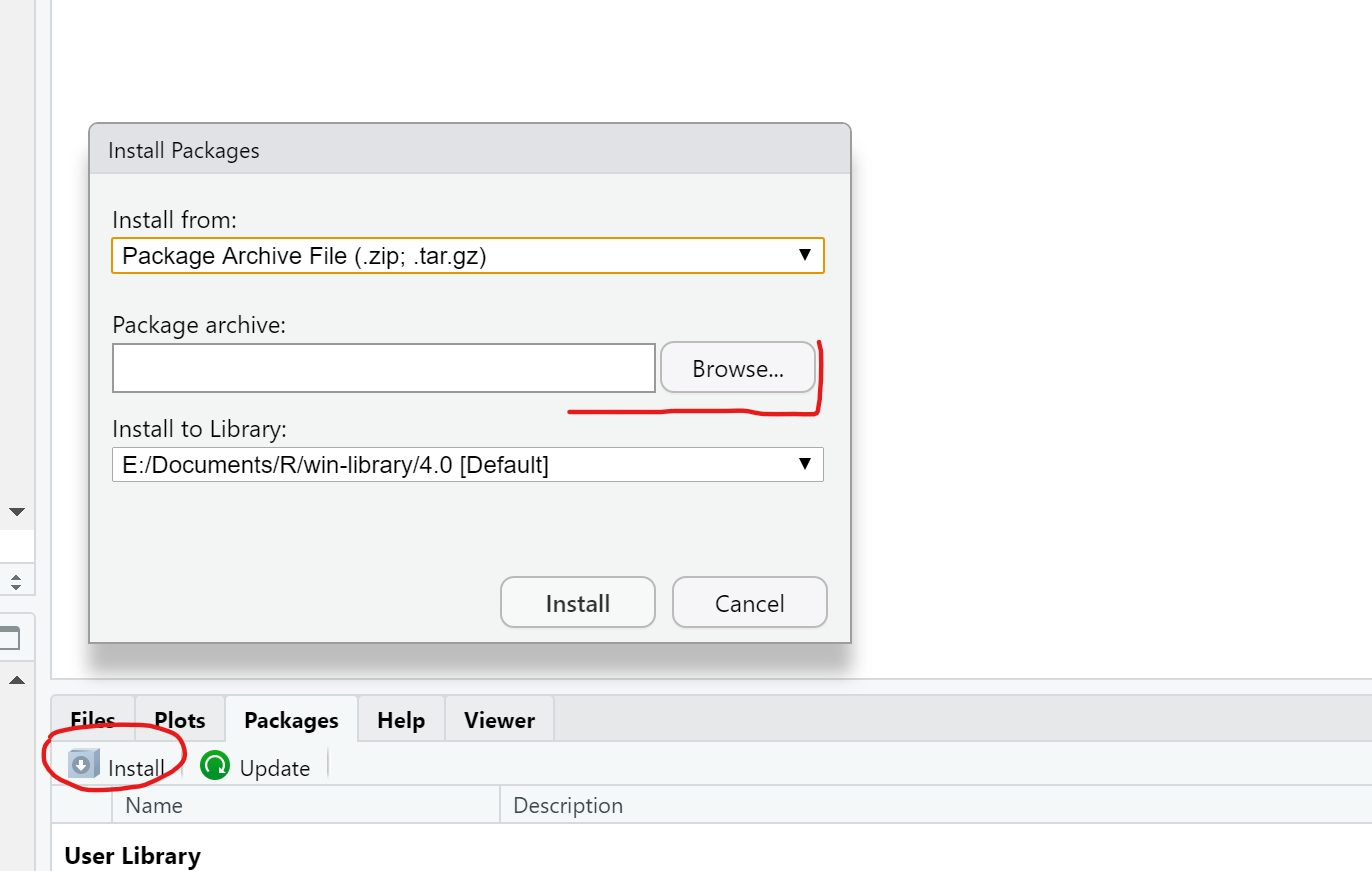

You don't need to unpack the .zip archive. Besides, if you have files locally, you need to set the repo parameter to NULL and specify the library type - win.library.
The full command for installation will look like this:
install.packages("path_to_zip_archive", repos = NULL, type = "win.binary")
Also, if you are using RStudio, you can use an alternative installation method by specifying the path to the library in the installer next to the list of installed packages.
