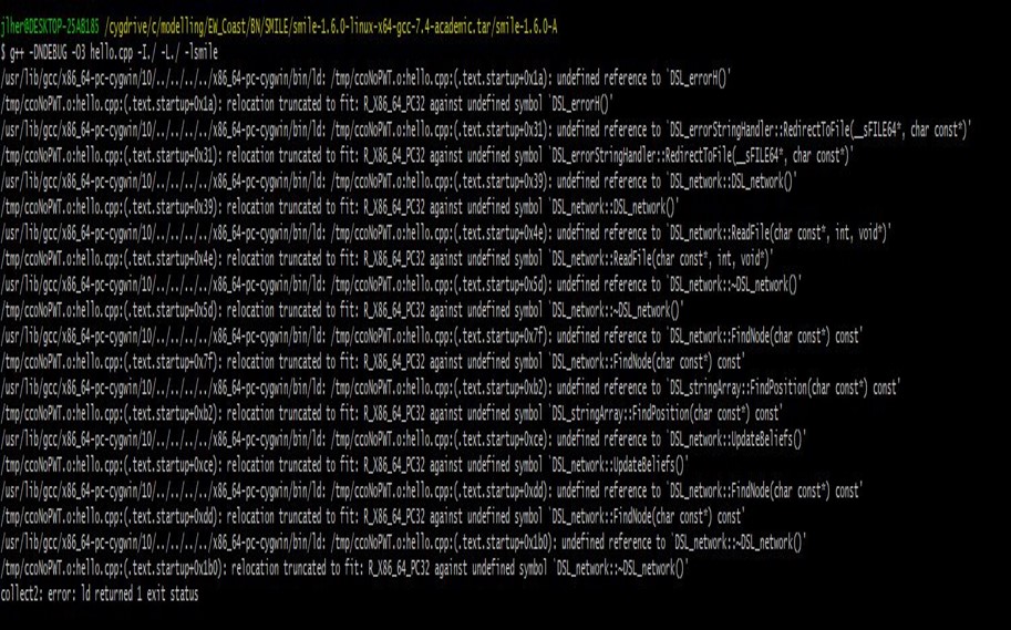

Hi, I am a new user. I just downloaded SMILE and the license and I am trying to start with the Hello.cpp example.
Since I don’t have Linux in my computer and am using Cygwin instead. After unzipping the files, I navigated to the folder where the files are located. I also copied the license files, the hello.cpp and the VentureBN.xdsl into that folder.
Unfortunately, I got several errors when trying to execute the script (Please see the screenshot attached). I have done some research and it might the a linking-related error. However, I am not an expert in g++ so I cant really look deeper into that. Please, could you provide some guidance to resolve the problem and help to figure out this issue?
Many thanks!
Juan
Re: Compiling error: undefined reference to
We currently do not provide SMILE binaries for Cygwin. If you're on Windows 10 and want to use gcc, consider Windows Subsystem for Linux (WSL)
Alternatively, you can use a free community edition of Microsoft's Visual C++.
