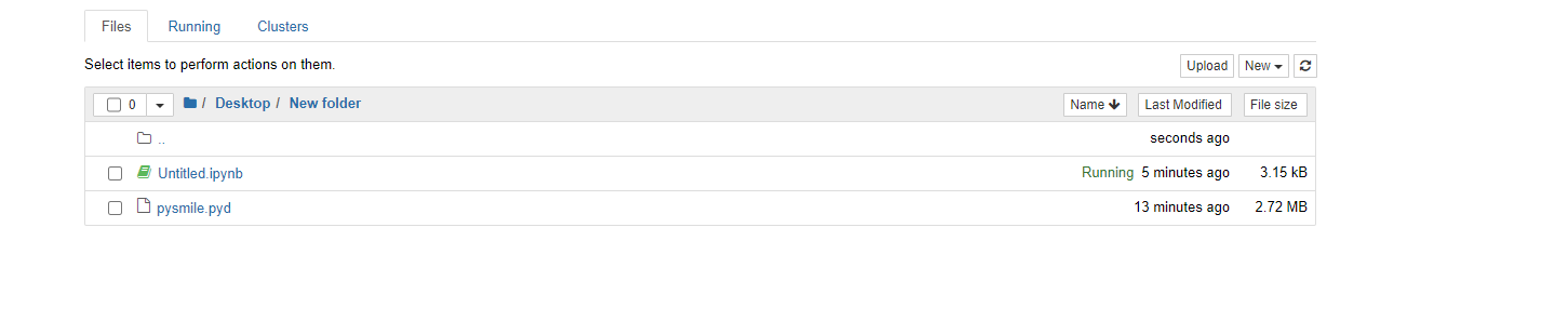

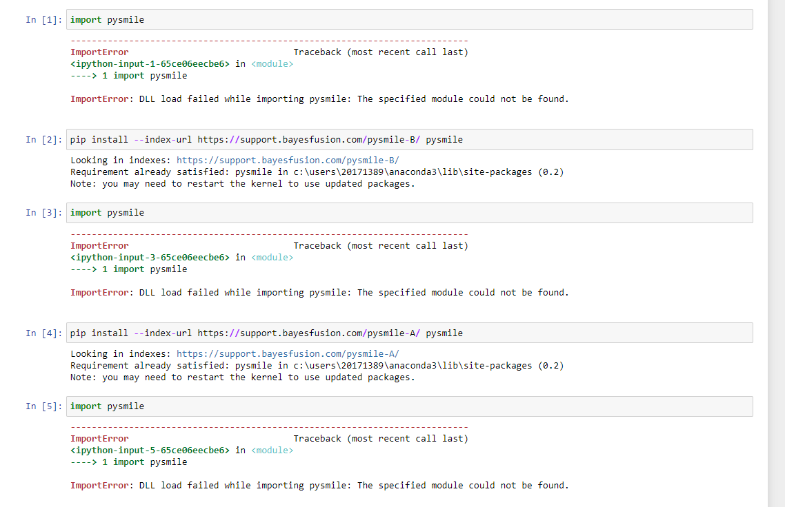

I tried to import pysmile in another computer with Windows system, I download the pysmile package on the website: https://download.bayesfusion.com/files. ... y=Academia, I download the pysmile-1.6.0-win-x64-python-3.7 academic.zip and uncompress this folder, then put the pysmile.pyd into a new folder like below "WeChat Image_20210307013204.png" figure, then i create a new python file. it reminds me: ImportError: DLL load failed while importing pysmile: the specified module could not be found.
then I tried to pip install pysmile by pip install --index-url https://support.bayesfusion.com/pysmile-A/ pysmile, i get the same error;
I have tried to use pip install --index-url https://support.bayesfusion.com/pysmile-B/ pysmile, then i get the same error when I import pysmile.
the procedure as below figure1.

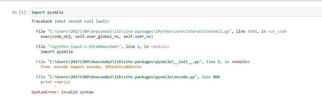

I also tried to create a new empty folder without anything, then create a python folder, i also get the error, it reminds me SyntaxError: invalid syntax. the error like figure 3.

At first, you have to unistall pysmile version 0.2
Second - to get the correct version from our index, use the command below:
Note that PySMILE may not be fully compatible with the Anaconda - we recommend using the official binaries from python.org
pip uninstall pysmileCode: Select all
pip install --no-cache-dir --index-url https://support.bayesfusion.com/pysmile-B/ pysmileRe: ImportError: DLL load failed while importing pysmile: the specified module could not be found
