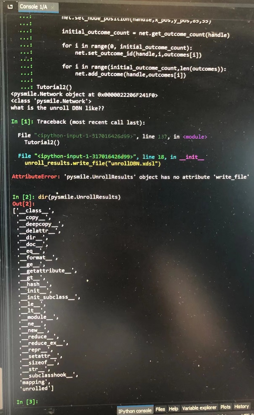

thank you very much! But when I use these two rows to save the unrolled network, it tells me " AttributeError": 'pysmile.UnrollResults' object has no attribute ' write_file'.
I use dir(pysmile.UnrollResults),write_file is not the attribute of pysmile.UnrollResults, as shown in attached picture.
could you please tell me how to store it then? thank you very much!
- WechatIMG4.jpeg (254.71 KiB) Viewed 102364 times

This is my mistake in the previous post - use write_file method on unrolled property.
unroll_results.unrolled.write_file("filename.xdsl")
