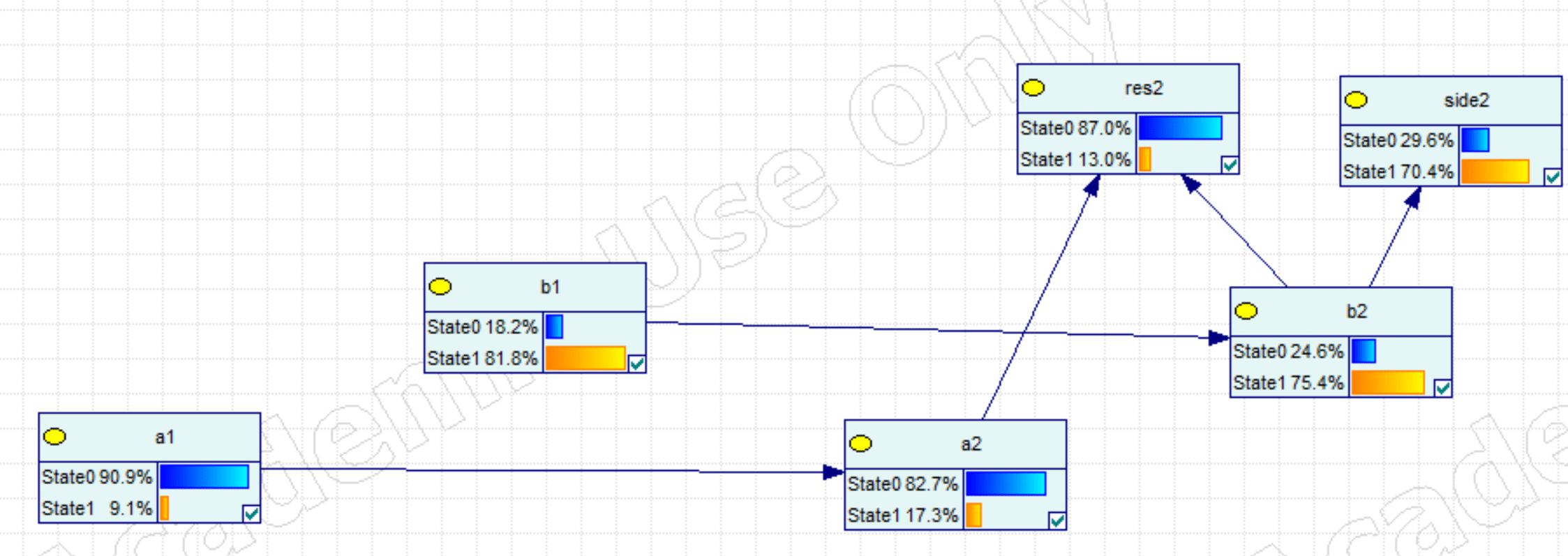

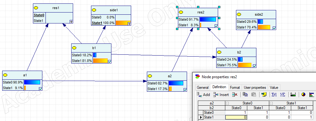

Se the following diagram:
This diagram mimics a dynamic net with 2 time-slices. The node res2 is of interest, this node has a definition that requires both a2 and b2 to be in state1 for it to be in state1 (see the opened definition). There is evidence on the res1 and side1 nodes.
I would have imagined that the following holds with this definition:
P(res2=state1) = P(a2=state1)*P(b2=state1)
as long as there is no evidence affecting res2 or its children (things it is pointing at).
If this was the case then P(res2=state1)=0.13, which it is not (it is 0.083).
The reason I hold this beliefe is that i thought this network should uphold the 1.order markov assumption, stating that the states at timestep 2 should only be affected by the posterior states at time-step 1 and the measurements at time step 2. Should it then not be equivalent with the following network:
This network acts the way i suspect.
What is the cause of the discrepancy between what i expect and what happens? What am i not seeing.

The error that you are making with your calculation/formula is assuming that a2 and b2 are independent of each other and they are not. Because there is evidence in res1, a1 and b1 are dependent of each other and they make a2 and b2 dependent as well. You can check this by observing one of the two variables (a2 or b2) and seeing that the posterior marginal changes in the other. "Update immediately" option will work best. The dependence between a1 and b1 is through an observed common descendant res1 (child of both in this case). I hope this explains why the result is not what you expected.

You are off-course correct. If I set evidence on side2 it will affect b2 which will affect b1 which will affect our believe on whether a1 or b1 caused res1.
I was for some reason convinced that the Markov assumption would hold with a factored representation, which it apparently does not...

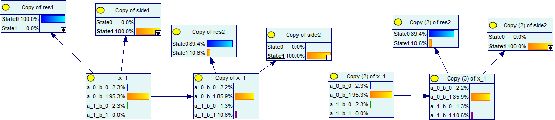

Just something that might be interesting for someone. If you make super-nodes consisting of all possible state combinations, as I have done in the picture below, then the first order markov assumption holds, and we do not need to consider the evidence at time-step 1 if we update to posterior value of x_1. This is of course useless for any larger networks. Updated file with super-nodes:
If I'm not misunderstanding you, I think there is a misunderstanding on where I'm putting the evidence. I'm putting the evidence on the res and side nodes, not on the a and b nodes. In this case, I don't think what you propose can be done? I guess in this case there is not much you can do without losing information?

Your super-nodes get priors equal to their posteriors before removing the nodes from the previous slices, correct?
