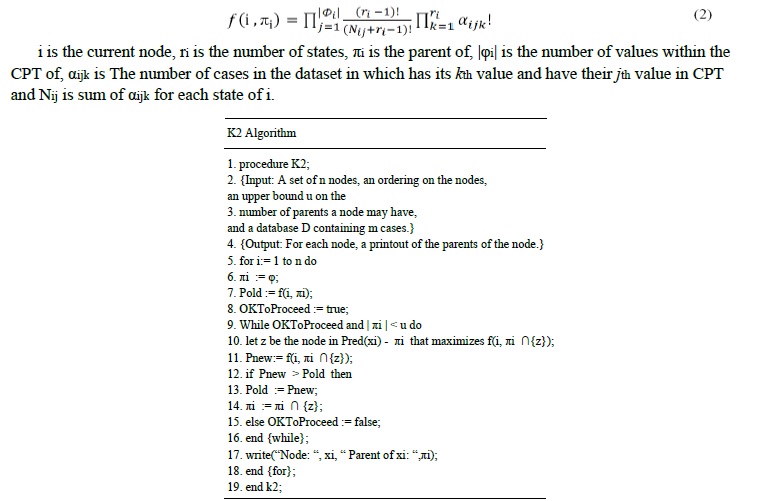

I have one more doubt about the algorithms bering used for BN learning.
According to the methodology of my analysis, I must use K2 algorithm introduces by Cooper & Herkovitz, 1992. (Please see attachment)
According to the GeNIe User's guide, I think "Bayesian Search" is based on K2. Am I right?
Can you please explain me in more detail way?

Thank you very much for your explanation. Appreciated.

- K2 algorithm model.
- K2 Algorithm.jpg (89.89 KiB) Viewed 20887 times

Hi Ashwani,
You are right in that the Bayesian Search implementation in GeNIe/SMILE is based on the algorithm proposed by Cooper and Herskovitz. You may also want to look at the paper by David Heckerman "A Tutorial on Learning With Bayesian Networks". It contains a couple of new ideas that enhance Cooper and Herskovitz algorithm. Here is one of the places where you can find it:
https://arxiv.org/abs/2002.00269
