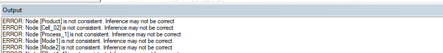

I have used PySmile to generate the Xdsl file. I imported the generated file into GeNIe to check how the network looks. There I found for all the created nodes the following error is displayed in the GeNIe output window ("ERROR: Node [XXXX] is not consistent. Inference may not be correct."). Attaching the image of the error below for further reference.

This error is logged during file load when the definition of the node (most likely CPT) is inconsistent; the columns of the table do not sum to 1.0. If you used set_node_definition in your PySMILE program, check the ordering of elements in the definition array. See the "Multidimensional arrays" chapter in SMILE Wrappers manual, or go directly to

Yea the order of CPT values that I entered through set_node_definition was incorrect. I followed the ordering as mentioned in the "Multidimensional arrays" chapter in the SMILE Wrappers manual. Still, it went wrong. I will correct it.
