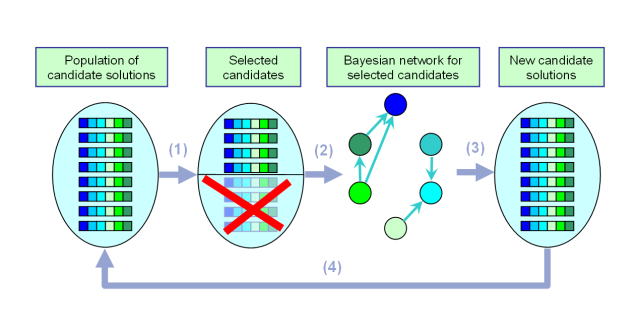

shooltz[BayesFusion] wrote: Wed Mar 04, 2020 8:28 pm Which structure learning algorithm is used? If possible, please post your network (after learning, but before the update) here.
Attached image of how the process takes place.
