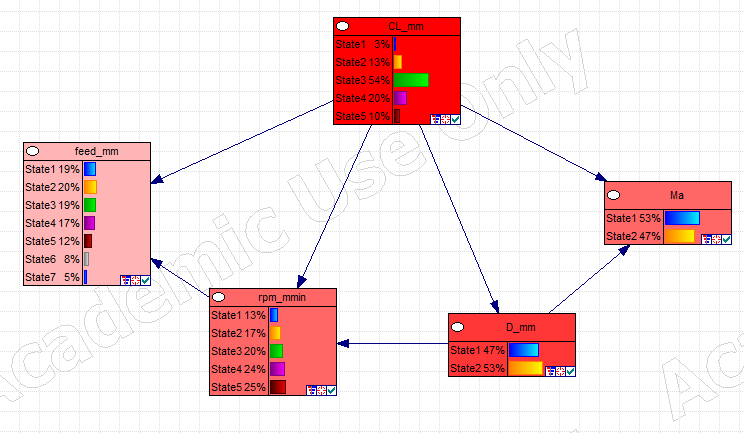

I have established a bayesian network as following figure, there are five notes and each note's state is shown in figure.

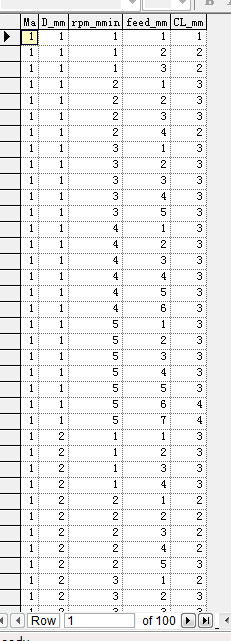

but I only have 100 datasets as the following figure, I don't know the data samples is proper, is there any principle or experience to decide how many data samples is need to establish the bayesian? Could you give me some advices.

There is never too many data records in learning and as their number increases, the quality of your parameters will as well. I have seen a heuristic "ten times as many records as the number of variables" but it is really just a heuristic that can be easily criticized. Another way of estimating the number of records that you will need is to look at your largest CPT. In your case, it seems that the variable feed_mm will have the largest CPT (5*5=25 columns and 7 rows). Your hundred records will have to distribute among the 25 columns, which gives you roughly 4 records a column. It is hard to learn a probability distribution over 7 outcomes from just 4 records. Another difficulty is that the distribution among the 25 columns is not going to be uniform and there will be many columns with zero records. So, I agree with you -- you have too few records to learn from.

marek wrote:There is never too many data records in learning and as their number increases, the quality of your parameters will as well. I have seen a heuristic "ten times as many records as the number of variables" but it is really just a heuristic that can be easily criticized. Another way of estimating the number of records that you will need is to look at your largest CPT. In your case, it seems that the variable feed_mm will have the largest CPT (5*5=25 columns and 7 rows). Your hundred records will have to distribute among the 25 columns, which gives you roughly 4 records a column. It is hard to learn a probability distribution over 7 outcomes from just 4 records. Another difficulty is that the distribution among the 25 columns is not going to be uniform and there will be many columns with zero records. So, I agree with you -- you have too few records to learn from.
