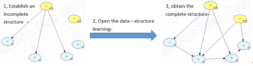

marek wrote: If you insist on a structure similar to a TAN/ABN, please enforce it through background knowledge -- put links that you want to be there and run the algorithm to add additional links.
Thank you for your advice, you mean I can establish an imcomplete structure, then run the TAN algorithm to add additional links. like the figure below
But in GeNIe, I do not know whether it will do. Up to now, I just know GeNIe can learn a new network, but can not add additional links based on an imcomplete structure. How to realise that like the above figure.

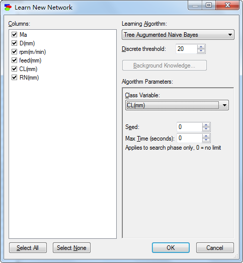

shooltz wrote:you should use Bayesian Search learning algorithm and create the network structure in the background knowledge editor.
I just try your advice, In GeNIe, TAN learning algorithm can not add the background knowledge editor, like the picture below.
Re: How to classify more than one variables when learning structure
As I indicated in my previous post, you should use Bayesian Search algorithm with background knowledge.
