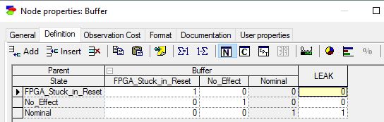

I'd like to set weights based on Parent State names and the Noisy Max node state names.
What's the best way to determine Parent states?
Also, what's the best way to determine Parent names?
Are those in the Noisy Max node or do I need to traverse the parents?
