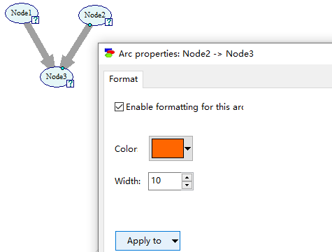

Hello, I wanted to change the colour of the arrow, I made the change in the arrow properties tab, and after changing it and clicking apply to it, it only changed the width of the arrow and the colour is still the default light grey. Is this a bug or is it not possible to change the colour of the arrows or is there something wrong with the way I did it?

The light grey colour of the arcs indicates that Node1 and Node2 do not affect Node3. When you change the definition of Node3, the colour of the arcs should be as you set in the properties.
MoumouZhou
Posts: 8
Joined: Fri Feb 28, 2025 2:58 am
Re: Arrow colour
Post by MoumouZhou »
OK, thanks! The colour did change after giving the definition. Then I'd also like to ask if it's possible to change the initial colour of this arrow line, or is it only possible to have the colour change once the two nodes have had an effect? Because this grey colour looks a bit light, I would like to change the colour of the initial state of the arrow.

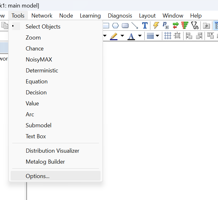

It is possible in Tools -> Options Menu.

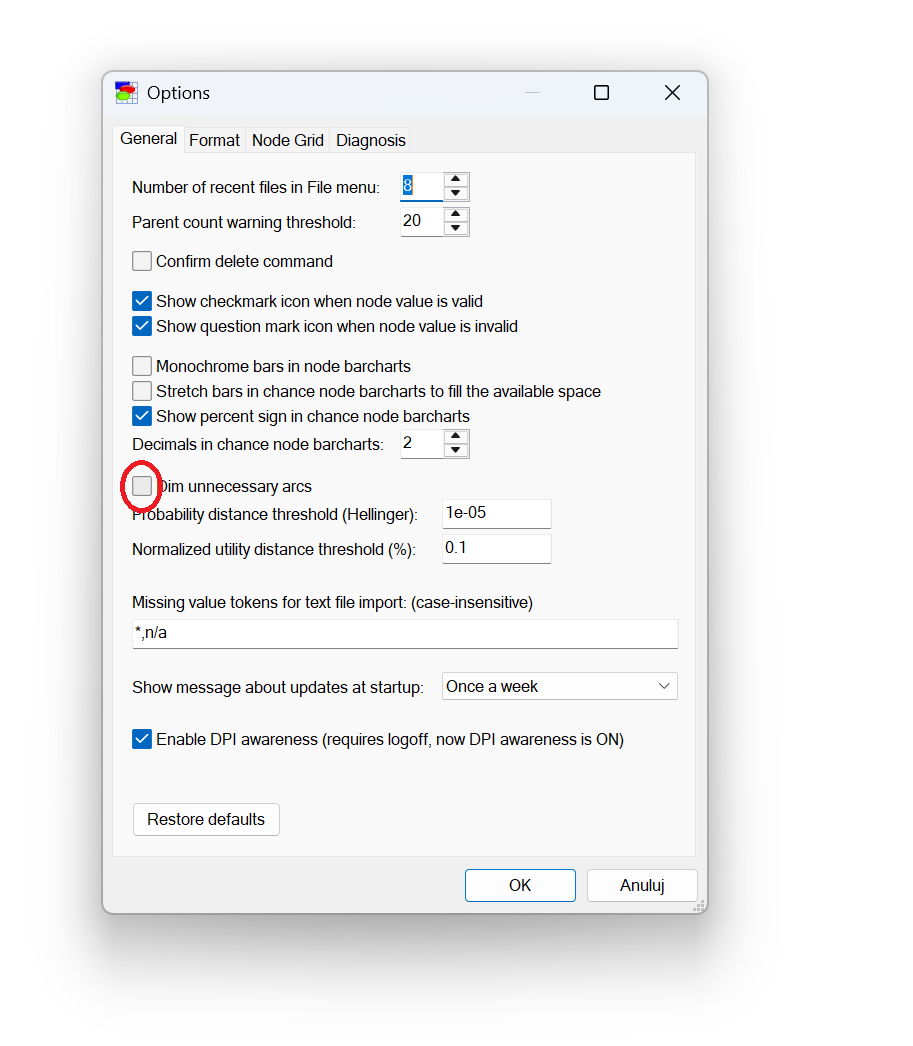

Then, you have to uncheck "Dim unnecessary arcs" checkbox.
