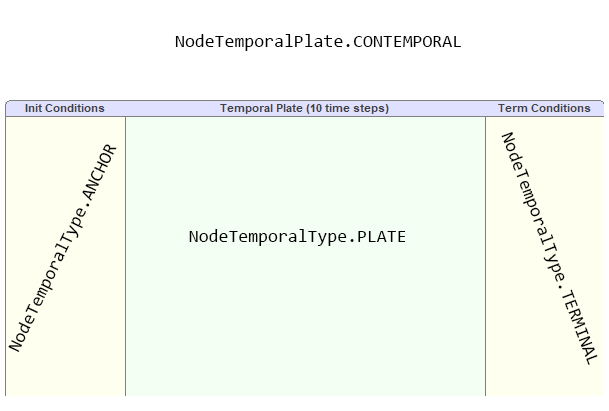

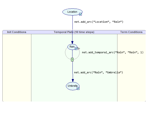

I'll try to explain PySmile DBN usage based on GeNIe documentation: https://support.bayesfusion.com/docs/Ge ... ngdbn.html
1. Create CPT nodes, ex.
net.add_node("Location")
net.add_node("Rain")
net.add_node("Umbrella")
2. Set node temporal types
net.set_node_temporal_type("Rain", pysmile.NodeTemporalType.PLATE)
net.set_node_temporal_type("Umbrella", pysmile.NodeTemporalType.PLATE)
Default type is CONTEMPORAL, so you don't have to change Location node type.
3. Create arcs
4. Set node definitions
net.set_node_definition("Location", [0.5, 0.5])
net.set_node_definition("Rain", [0.9,0.1,0.2,0.8])
net.set_node_temporal_definition("Rain", [0.7,0.3,0.3,0.7,0.001,0.999,0.01,0.99])
5. Update beliefs and check if everything is ok.

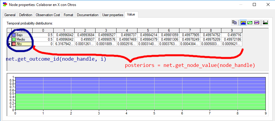

Well, net.update_beliefs() seems to go well, but then I have problems printing the posteriors:
Network written to colaborar_din.xdsl
Starting inferencing...
Posteriors with no evidence set:
P(Colaborar_G = Bajo) = 0.5
P(Colaborar_G = Medio) = 0.5
P(Colaborar_G = Alto) = 0.0
Traceback (most recent call last):
  File "modest_dynamic.py", line 180, in <module>
    InferenceOnNetwork(cn.get_network())
  File "modest_dynamic.py", line 146, in __init__
    self.print_all_posteriors(net)
  File "modest_dynamic.py", line 167, in print_all_posteriors
    self.print_posteriors(net, h)
  File "modest_dynamic.py", line 160, in print_posteriors
    value = net.get_outcome_id(node_handle, i)
RuntimeError: basic_string::_M_construct null not valid
Please, find attached the code and the resulting network.

    def print_posteriors(self, net, node_handle):
        node_id = net.get_node_id(node_handle)
        if net.is_evidence(node_handle):
            print(node_id + " has evidence set (" +
                                     net.get_evidence(node_handle)) + ")")
        else :
            posteriors = net.get_node_value(node_handle)
            for i in range(0, len(posteriors)):
                p = posteriors[i]
                print("P(" + node_id + " = " + value + ") = " + str(p))
When i reaches 3, Python trying to get element that not exists. You should change
to
value = net.get_outcome_id(node_handle, i%net.get_outcome_count(node_handle))

Why beliefs initialization goes through 10 steps in time?
It depends on Slice (Step) Count variable. You can change it by calling ex. net.set_slice_count(4) (four steps). Remember to update beliefs.
How do I add evidences along time? (I have a guess on this one, but I ask it just in case I am wrong)
net.set_temporal_evidence(handle, slice, outcome)
Is there a way to recover the net at time t (all nodes probability distributions at time t)?
If you want to get network definition, you should call get_node_temporal_definition method for each node. If your intention is to read the node values, use get_node_value method and read values corresponding to searched 't' value.

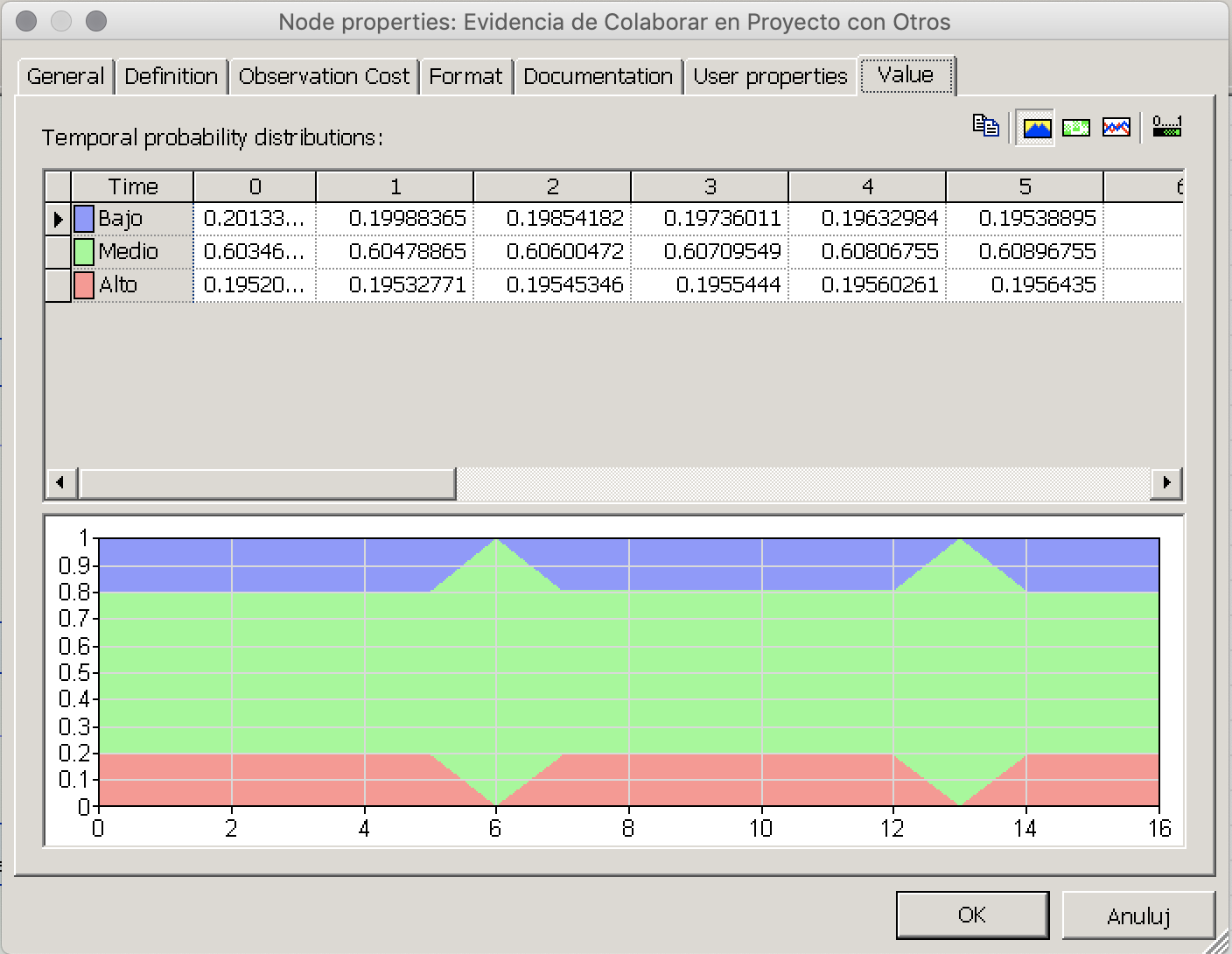

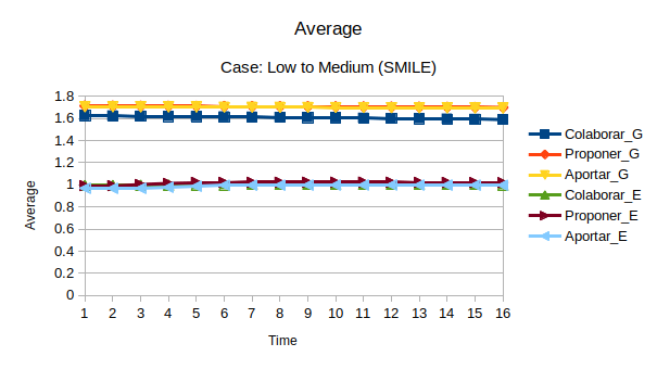

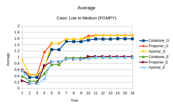

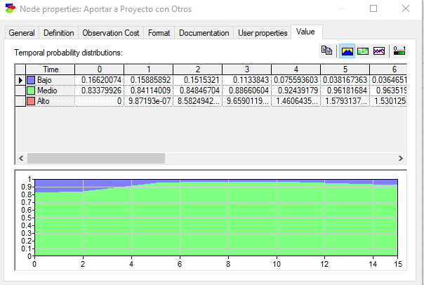

Thank you very much for your help. I can get the 16 time slices I wanted. However, I guess I am doing something wrong because the behaviour is not as expected. Given the temporal evidence
Competencia Tiempo Nivel
'e_proponer' 1 0
'e_aportar' 2 0
'e_proponer' 4 1
'e_aportar' 5 1
'e_colaborar' 7 1
'e_proponer' 10 2
'e_aportar' 11 1
'e_colaborar' 14 1
I get the following results with SMILE:
They are too flat, as if the network is almost no reacting to the evidence. Consider, for example, the same evidence on PGMPY
These results are more credible.
So, I am attaching the code, hoping you have time to have a look at it.
modest_dynamic.py.txt
(6.93 KiB) Downloaded 12204 times

You should consider usage of has_temporal_evidence/is_temporal_evidence methods instead of is_evidence method. Slice count should be changed before adding evidence. Apart from these two things, the rest of code seems to be fine.
Could you tell me, how to reproduce these charts?
Genie shows, that node values change in time (Aportar_E at image).

Thank you! I would fix my is_evidence call. The charts are created using a spreadsheets (attached). And yes, the probabilities move, but too little. Consider the first pair or evidences on value 0 for e_proponer and e_aportar, they should have moved the probabilities much more than they are, as it happens with pgmpy. Unless in the SMILE case the temporal conditional are too strong.
bajoMedio16-smile.zip
(45.44 KiB) Downloaded 12279 times
bajoMedio16-pgmpy.zip
(33.33 KiB) Downloaded 11873 times

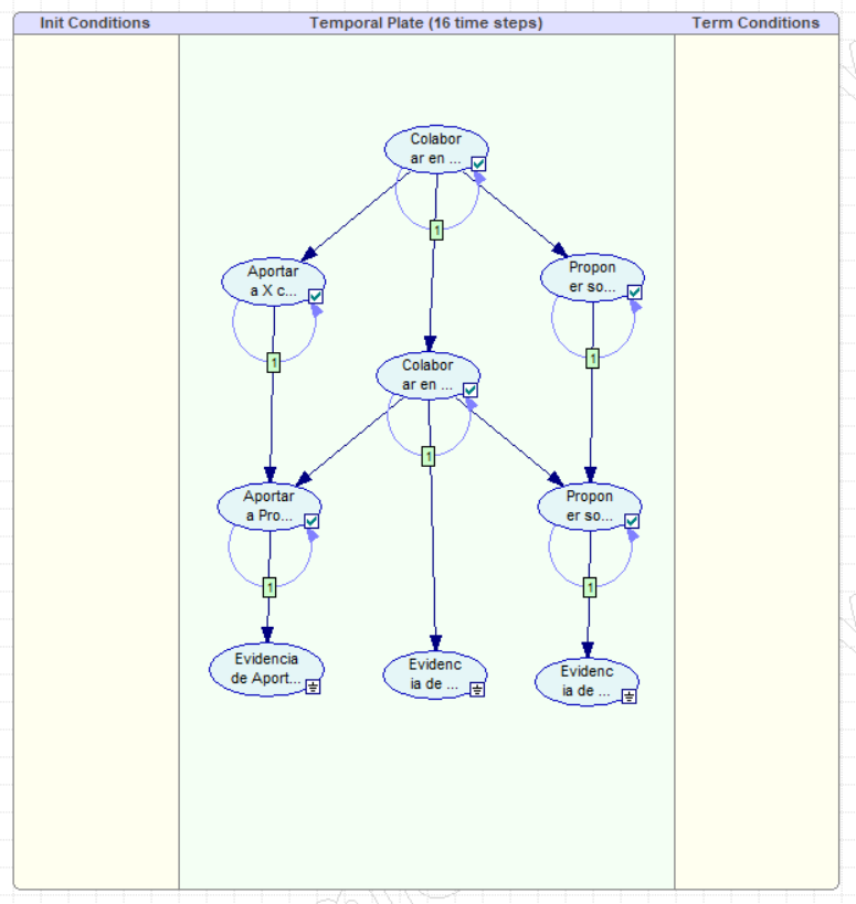

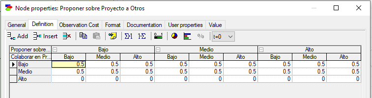

I have the opportunity to install Genie on a Windows machine, and I get a nice picture of my map:
I have followed the manual and revised the tables, and everything seems to be fine, bot the t = 0 definitions,
        net.add_arc(cg, pg)
        net.add_arc(cg, ag)
        net.add_arc(cg, ce)
        net.add_arc(pg, pe)
        net.add_arc(ce, pe)
        net.add_arc(ag, ae)
        net.add_arc(ce, ae)
        net.add_arc(ce, ec)
        net.add_arc(pe, ep)
        net.add_arc(ae, ea)

Yet, the model seems to be insensitive to to evidence. So I am wondering whether what I miss are initial conditions of some kind, or there is something deep wrong in the model.

Perhaps you should start setting evidence from time = 0 (decrease each t by one). I have done every step that you mentioned and calculations seems to be fine.

Well, it looks like there is some differences in understanding what a DBN is. I was thinking on something that evolves in time; i.e. conditional probabilities in nodes in slice t+1 depend only on conditional probabilities in nodes in the same slice and slice t. So evidences for e_proponer = 0 and e_aportar = 0 in slices 1 and 2 would make conditional probabilities for nodes 'Proponer_E' and 'Aportar_E' to "move" towards 0. But it seems to me now that what the system tries to do is to consider all the slices and evidences all together, as a large static BN, and considering all evidence together.
Is that the case?
Re: Sample code (Python preferred) for Dynamic Bayesian Network
Your temporal arcs have order 1, therefore your CPTs in t+1 are conditioned on nodes in t+1 and t. However, the calculated posterior probabilities depend on the entire unrolled network and the evidence set. To calculate the posteriors, SMILE unrolls the network into a static BN containing the specified number of slices, performs inference and copies the results into original DBN. You can use the 'Unroll' command in GeNIe to visualize the process.
For more info, see Using GeNIe/Dynamic Bayesian Networks chapter in GeNIe manual.
