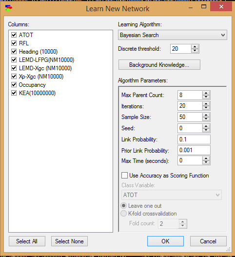

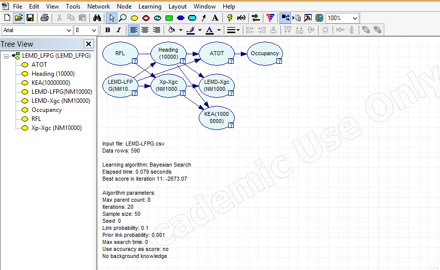

I tried to find the relationship(network) of some items by using Genie. I followed next steps:
1. I got my file in format csv.
2. Discretization of each row. There are 8 parameters (colums) and 590 rows.
3. Learn new network. I choose Bayesian Research, without change any initial parameters: discrete thresold: 20, iteration: 20, sample size: 50.
Initial Parameters- Bayesian Research

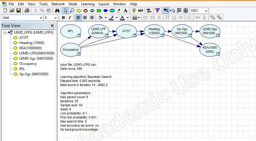

4. And I got a network. (Attachment 2)
Network 1
Network 1
The problem is, when I repeat step 1-3, without any change (same file, same disrectization, same parameters). However, I got another network in step 4. (Please see attachment 3)
Network 2
Network 2
I have no idea why the network changes.
Any answer will be appreciated!!! Many thanks!!!
Re: Bayesian Research -- Different networks with same initial parameter
You're using random seed value of zero, which means that actual seed is taken from the system clock and a couple of other system values. To obtain repeatable results, use nonzero seed.

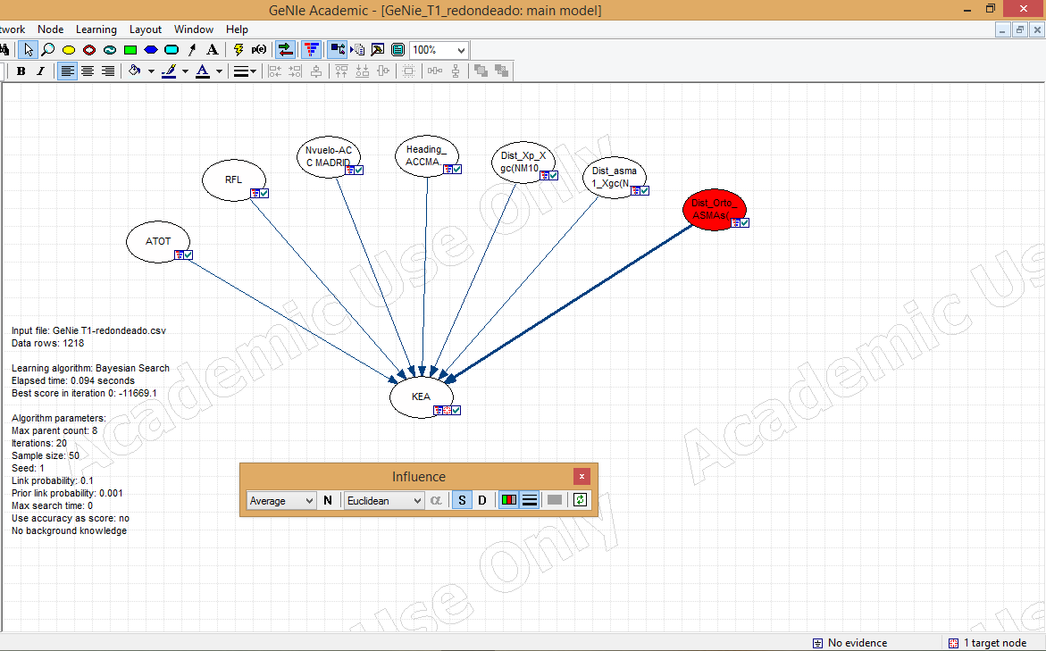

Hope you do not mind.... I have another question: as my object is to find the influence value of each parameter related with KEA(my last parameter). I re-constructed the network. I followed these steps:

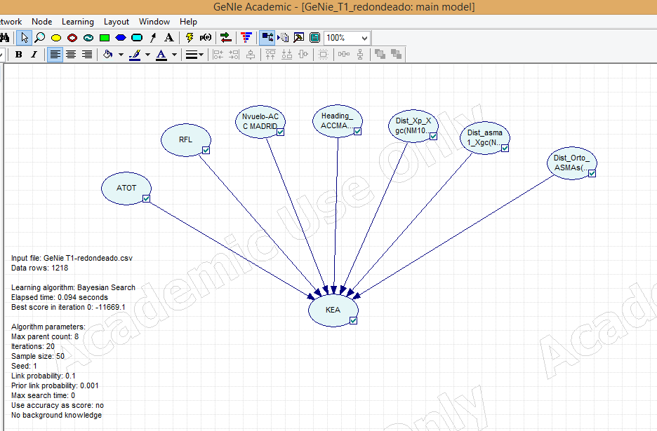

1. Connect the arcs and build a new network as you can see in this picture.
network for influence
New Network for influence 1.PNG (48.44 KiB) Viewed 25324 times
2. Learn Parameter : match the prameters and update the network.

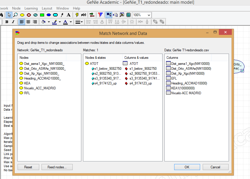

Learn parameters
Learn parameters
Learn parameter.PNG (42.6 KiB) Viewed 25324 times

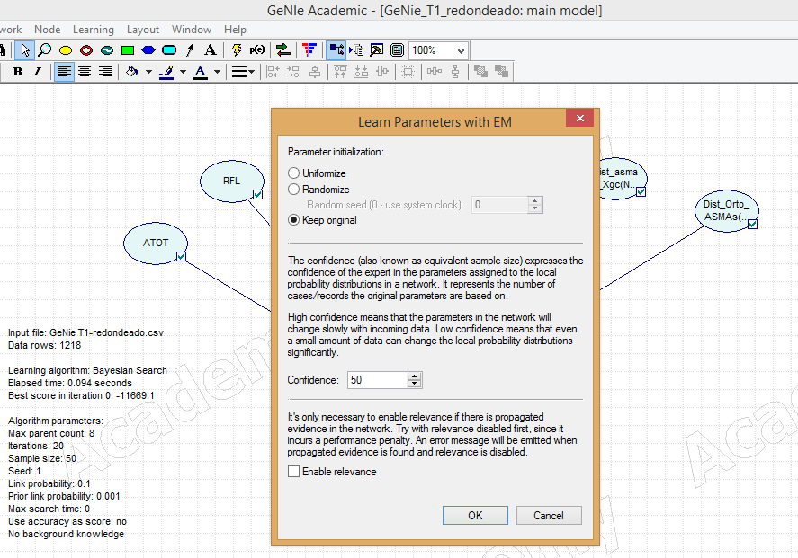

3. An automatic window is skipped: learn parameters with EM. I choose 'Keep Original' and Confidence '50' (the same number as sample size).
Learn parameters with EM
Learn parameter with EM.PNG (54.5 KiB) Viewed 25324 times

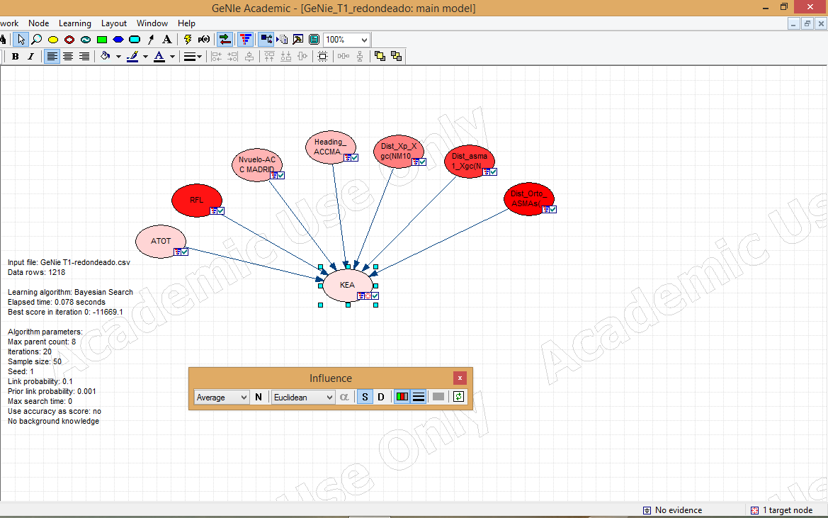

4. Finally I update the network and click on 'Strength of Influence' to get the influence value of each parameter related to KEA.
However, when I repeat again step 1-3 without change any input and click again on 'Strength of influence', the influence value of the parameters changes.
Do you know where the error is? (As Step 1 and 2 are only to match the parameters, I do not think there exist any incoherence, the problem may occur in Step 3).
Thanks in advance!!!
Apply sensitivity analysis for this. See Using GeNIe | Bayesian Networks | Sensitivity analysis in Bayesian networks chapter in GeNIe manual.

I also tried Sensitivity Analysis, but it changes every time when I rebuild the same network.
I attach two trials for your reference [Sensitivity Analysis & Strength of Influence]. All the previous steps are the same. but the final influence diagram result is different.
Trial 1: follow step 1 -3 I mencioned previously.
Influence distance of each parameter trial1
Trial 1.PNG (64.58 KiB) Viewed 25317 times
Trial 2: repite Trial 1 without any changes.
Influence distance of each parameter trial2
Trial 2.PNG (67.86 KiB) Viewed 25317 times
Don't mix strenght of influence and sensitivity analysis. Use one or the other. I recommend sensitivity analysis for your case.

shooltz[BayesFusion] wrote:Post two networks learned with identical seed here, so we can investigate the problem.
Dear shooltz,
I tried several times and I find the error! In step 3 I put sample size (confidence level) 50 instead of 100, it causes different results because Genie pick up randomly half of the samples (50%) to build the influence diagram.
when the sample size is 100, in all trials, my final Strength of Influence o Sensitiviy Analysis of each parameter get the same result.
Thanks a lot for your help!
